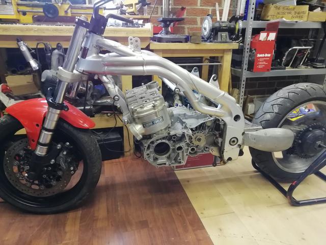

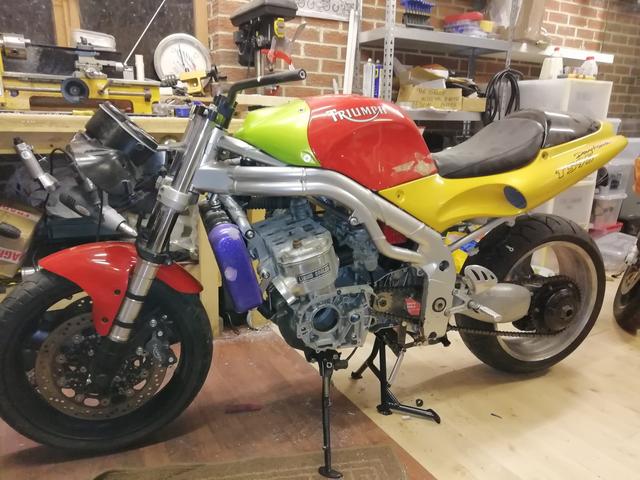

rear / upper adjustable engine mounts in place........
and with a bit of tweaking, the chain run is good, rear wheel axle, swing arm pivot and drive sprocket centres align, and my trusty spirit level says the motor is -
level :up:

Nice engine mounts. Just thought you might want to turn the rectifier/regulator up the other way to avoid water being funnelled in. I know it shouldn't leak but sods law says.....

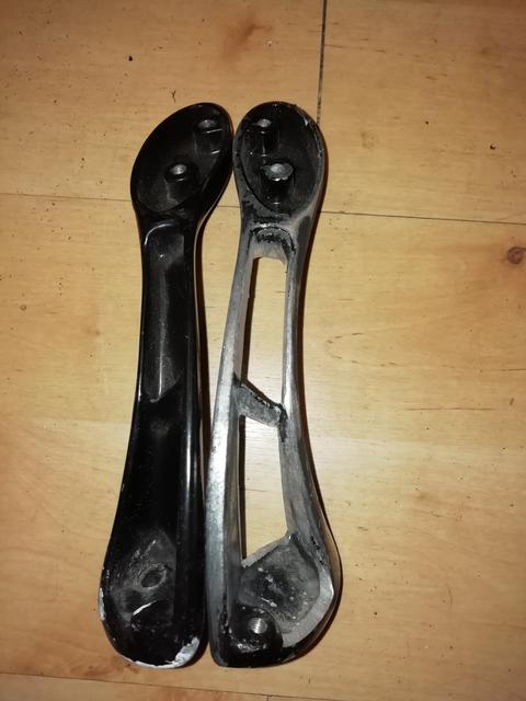

today's work - drilling and filing one of the original T595 fairing / mirror support arms.

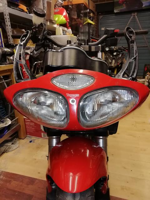

both modified mirror mounts fitted and my 3rd attempt at modifying a T595 nose fairing to suit..............

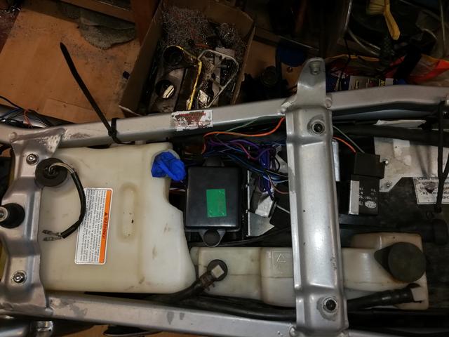

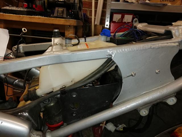

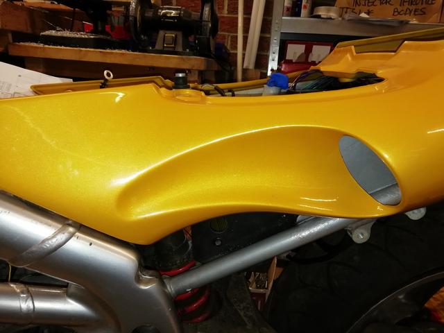

under-seat bits and pieces (2T oil tank, battery, fuse box, relays, coolant expansion tank and battery charger fly-leads) all in place. Battery sits in it's own space under the 2T oil tank (see post below), which is why you can't see it.

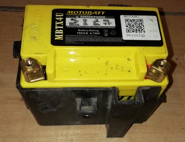

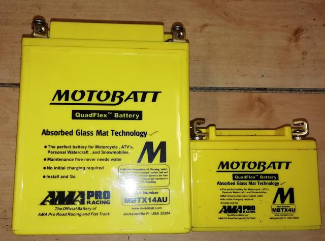

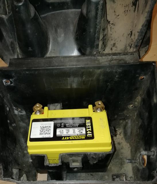

As I am not running the electric starter motor option for the Steam Triple motor, it means I can run a much smaller (lighter) battery.........
Triumph T595 on the left, RGV250 on the right.
There was nowhere to mount the RGV battery in the T595's battery compartment, so I purchased a VJ21 RGV250 battery box............
and set about cutting off all the mountings...........
leaving only the tabs for the securing strap to attach to. Snug fit...........

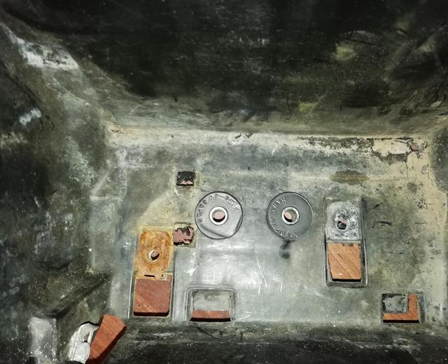

Then I drilled the floor of the T595 battery compartment to accept a pair of rubber mounts........
and here it is, bolted in place and looking lost...........
this modification allowed me to cut 1" off the top of the T595's battery compartment to allow the Aprilia RS125 2T oil tank to fit above it.
