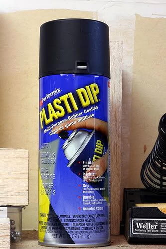

So, I taped off the two displays in the middle (after polishing them) and bead blasted the oxidation, dirt, and dust off it.
I then prepped and sprayed it with Satin Black Plastidip
Leaves a rubbery touch weather resistant finish on it.
'72 above -untouched '74 below -refinished
