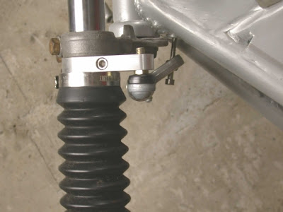

Get one from a GSXR
Post by krwalsh »
You can mount a standard damper to the fork leg. I think I got this one off a GSXR, but they are available from other aftermarket sources. I've seen them mounted above the triple clamps, but that didn't work due to the clubman bars. You can also mount them from the fork leg to the side of the frame. I tucked mine underneath because it looked a little cleaner.
Kevin R. Walsh '75 Suzuki GT-250 Cafe Racer
