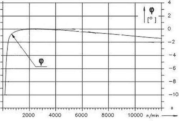

Ok so I sent a note to Powerdynamo today and here is the response I got.
paul,
this system does not have a special advance unit as such.
it can be added, info see
http://www.powerdynamo.biz/eng/info/advance.htm" onclick="window.open(this.href);return false;
and
http://www.powerdynamo.biz/eng/info/curves.htm" onclick="window.open(this.href);return false;
in our experience for this bike not needed (and also you would have to
tell us what characteristics to implement)
there is however some advance characteristics by virtue of its design to
enable better starting
http://www.powerdynamo.biz/data/ignipoi ... e_112i.jpg" onclick="window.open(this.href);return false;
the zero line is the basic setting you do as per assy instructions
edgar
edgar
