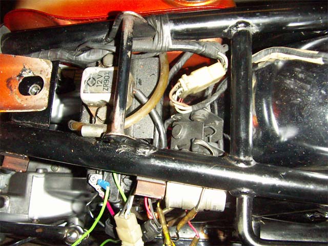

This pic I found online looks pretty close to stock.
This bike has a voltage regulator attached to the top of the battery box — your bike likely doesn’t have one.
The pic is from here:
http://www.motowasabi.com/archives/cat_suzukit250.html

the rectifier definitely goes on the inside of the frame. looking at the above photo i'd say the flasher unit attaches to the rectifier bolt. i always put my flasher units further in, but there again i use led flasher units
