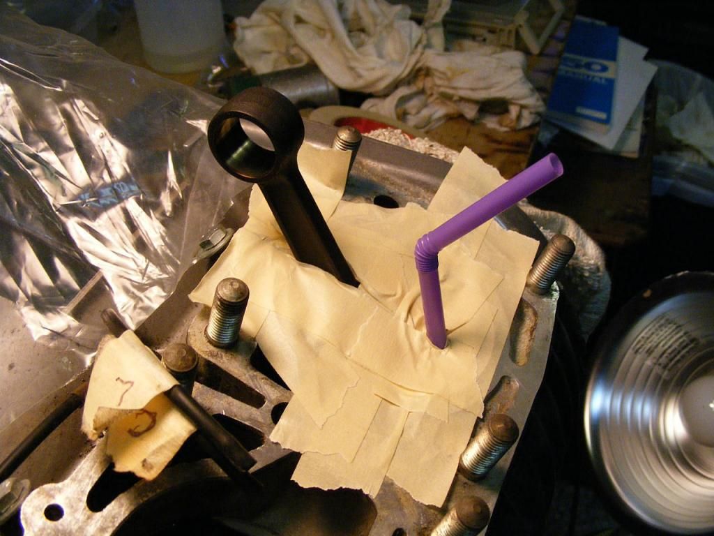

You guys can laugh all you want, but it worked! A quick blast of compressed air in the straw and the stuck SRIS pieces came right out. On the first try! (GT550)
