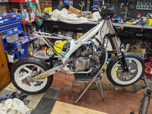

More front end work - the new Henry / Reed Contour Pro-Taper fat bars arrived yesterday, so time to fit those, the newly coated clamps and the VJ23 instrument pod.
Also added the NOS (from my Bimota spares stash) Brembo front master cylinder, the kill switch and a throttle housing (awaiting replacement).......
also attached the rear subframe, airbox housing and the reg / rec unit.......

test fit of the rear wheel (awaiting delivery of the rear disc rotor) so I could make the chainguard brackets and drill the swing arm to accept a couple of Rivnut fasteners.
I am more than happy with the fit and look of the Yamaha TZR250 3MA chain guard

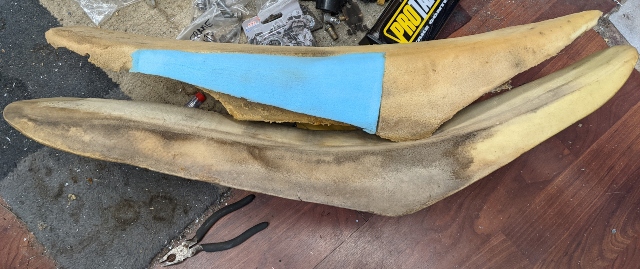

RMZ equivalent of a hugger - new rear shock protector fitted.........
and the standard seat foam (top) vs lowered seat foam (err - lower)........
I had to remove 97 mini-staples to get the outer and inner covers off - someone obviously enjoyed doing the stapling

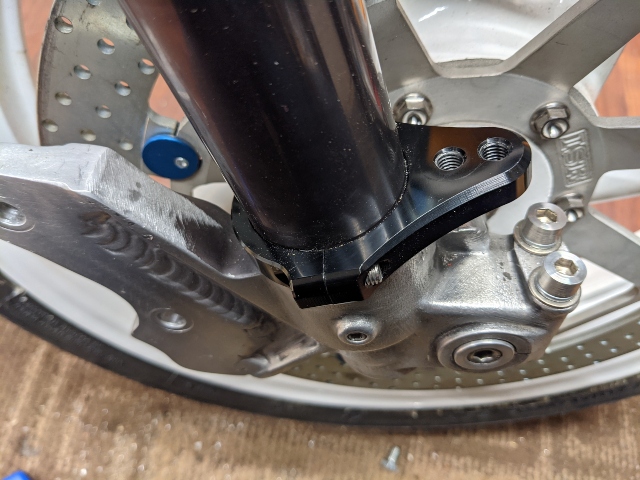

front mudguard sorted at last.
48mm steering damper clamp (1 each side)..........
make a pair of brackets..........
tidy them up...........
attach to clamp - upper bolt acts as a locating peg, securing bolt screws in from underneath............
attach mudguard (new stainless button head bolts on order).........
