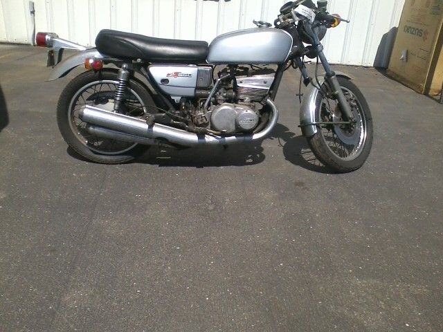

My build started with a $400 1974 GT550 that I paid about $440 too much for. I've restored and customized a few other bikes, but never anything as old as the GT or a two stroke. The engine was shot. It had been outside for years and unfortunately stored without a spark plug in the left cylinder, so the engine was full of water. :(
However, a few months later I bought an ebay engine and a few months after that a very nice restorable GT550 came along for $200 from a friend that owns a Suzuki dealership.

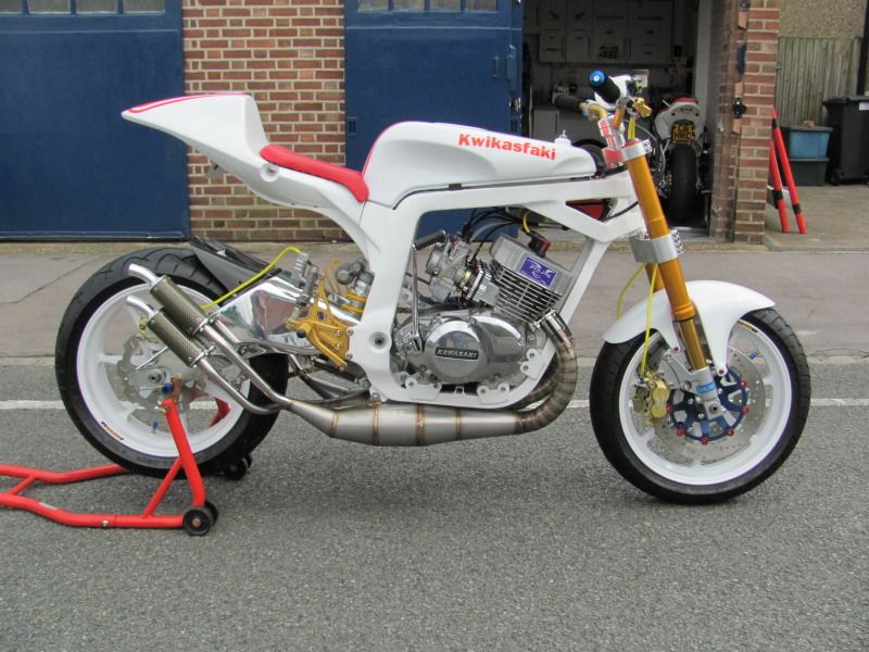

So, after needing a new direction, I came across a few H2 builds. One being Qwikasfaki by a fellow named Cabbie, the other being an H2 build in a 1990ish GSXR750 frame from an outfit in California build.

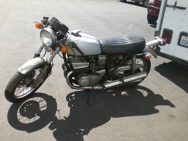

1974 GT550- $440
1976 GT550- $200

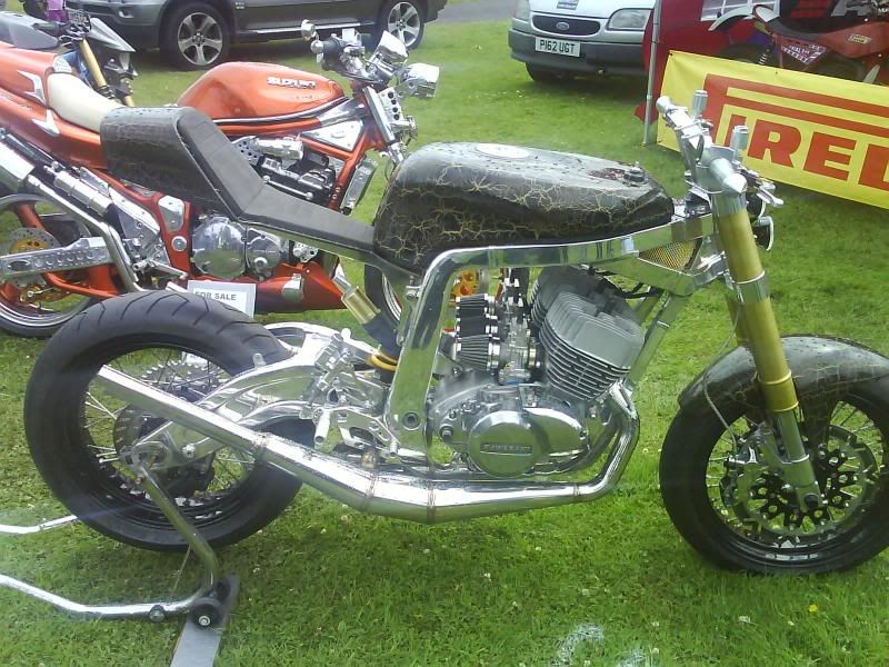

Quikasfaki and other inspiration

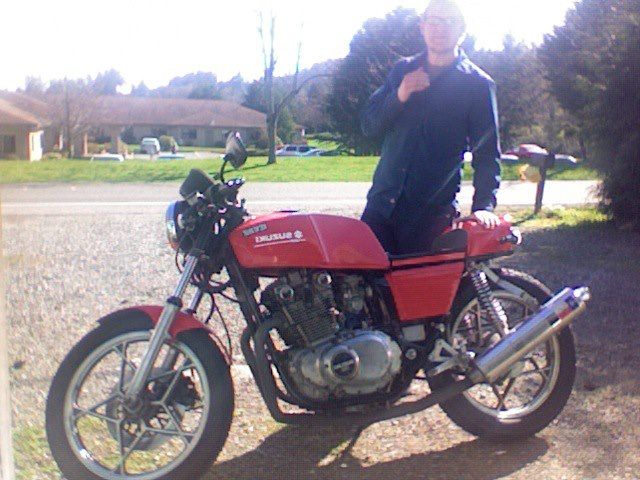

Here's my custom home built budget built GS450 cafe racer

The Kwikasfaki bike is a real work of art, very well done. He has used the GSXR400 frame, with the swinger being Aprilia (I think).

Yeah Aprillia swinger and Ducati wheels and front forks, I do believe. Might be gsxr forks with the duc wheel mated to them.

Kwikasfaki is amazing. Have you read his customfighters forum page? His eye for detail on the little things really pull that bike together. I love how he sanded out all of the weld seems so the frame is nice and smooth..
