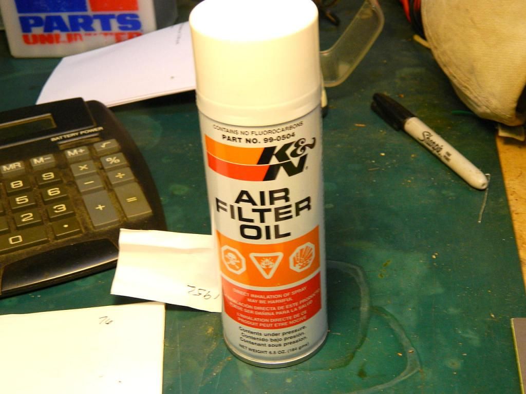

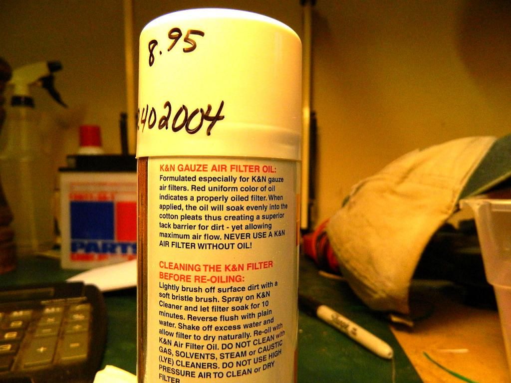

Way too often, guys with pods forget to oil them. Oiling is IMPORTANT! Not too much though. K&N makes a pod oil in a spray can. You need to 'mist' them till they are moist, but not wet. The K&N oil is red so it's easy to see what you are doing. I run cheapo pods, but I do use this oil.
