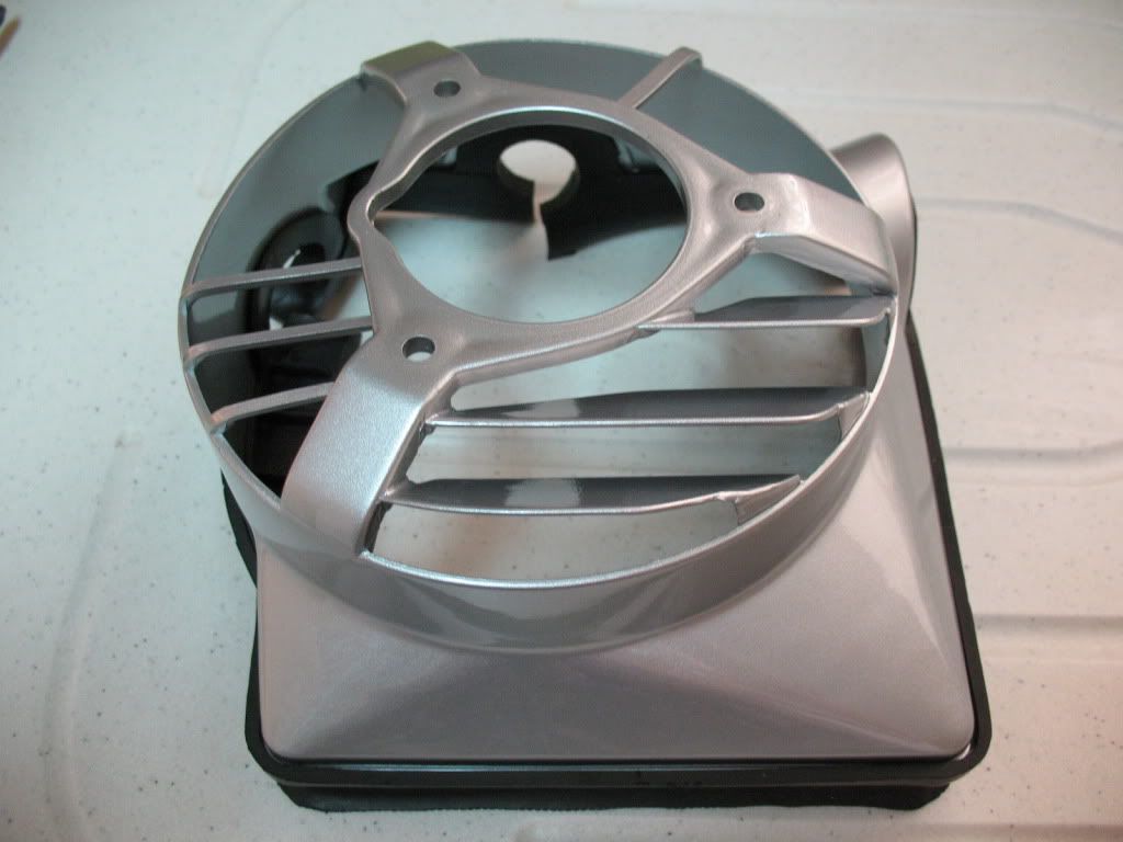

Look at this part close up for the finish, its been lightly sanded, had two coats of plastic adhesion primer applied, then sprayed and clear coated by that Harbor Freight gun, all done at 35psi. The gun can spray at lower psi but I have always used and prefer between 30 to 35 psi for painting.
I cannot see any difference between this finish and what the Sata and Devilbiss guns can produce under the same psi settings which is very annoying, as the cost I paid for them was mind boggling.
This is the true sprayed finish, no #3000 paper has been rubbed over the clear and then buffed etc
