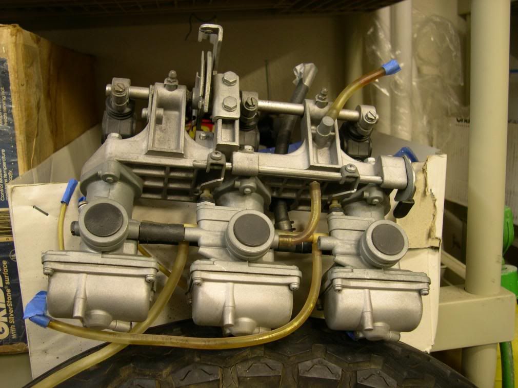

In the first photo you can see the valves better since the carburetor is removed.
The two outside arrows pointing to the yellow plastic valves are also going nowhere!
I don't think they ever had anything on them. Do you know?

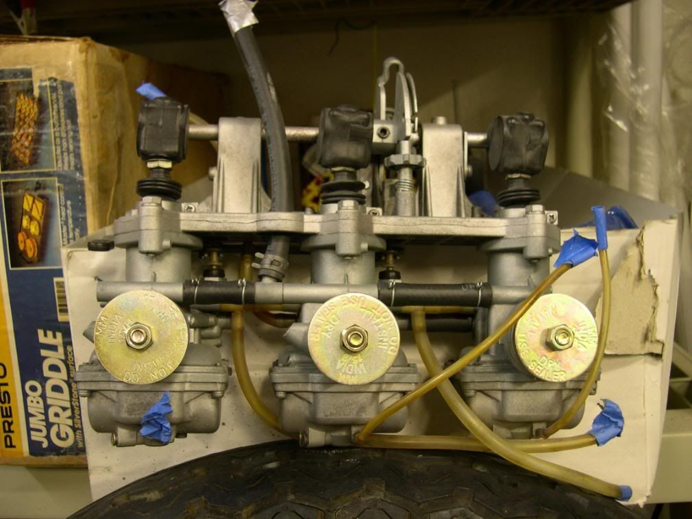

In the second photo I have one of the tubes off the reserve side of the petcock going to a valve on top of the second carburetor.
I feel that this may be wrong. Do you know?

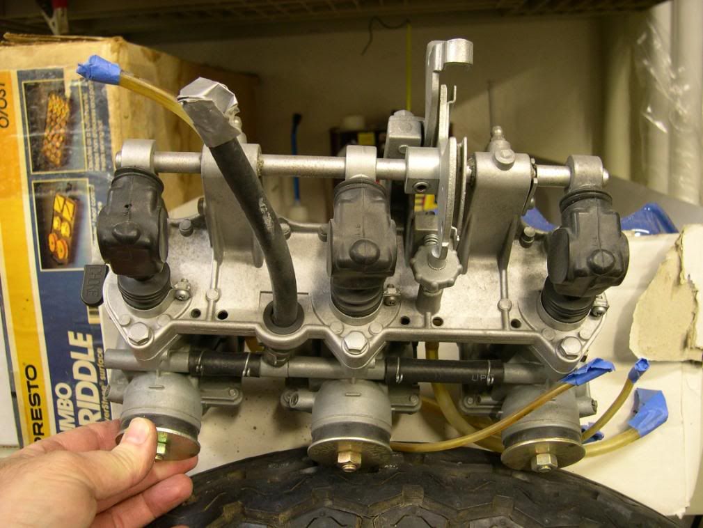

Here are my GT380 carbs, they may be of some help.
Terry

Thank you. Your photographs do help.
I drew arrows on your photographs and lettered them
a,b,c, d, and e
I do realize from your photos that I had D and E hooked up wrong.
I actually had a hose running from D into E. So thanks for that.
Could you or anyone tell me where those hoses hook up at on the bike?
I am not certain where to hook up hoses A, B, C, or D.
Thanks again. I really appreciate it. I can't wait to get this bike up and running.
Re: I need help! GT380 dies when I give it any gas.
The tubes B, C, D & E are simply breather tubes / overflows and just vent to atmosphere.
Tube A is the vacuum pipe that connects to the smaller brass tube on your petcock / fuel tap, to actuate the vacuum diaphragm in the tap ... that MUST be connected or a) the fuel tap will not flow unless on the 'prime' setting and b) it will run fatally weak.
And those tubes are not necessary. Tube 'A' on the other hand is important if the petcock is the original. I only have 4 tubes coming off the carbs on my 550 which are very similar. I have 'A' going to the petcock and 3 float bowl overflow tubes.
If you decide not to use tubes B,C,D and E, do not and I repeat do NOT cap them off. If for some reason the petcock has been changed and there is no place to hook up line A, that line should be removed and capped off at the center carb. Optionally, you can just plug the line. By all means do not leave line A open to the atmosphere. You will have a massive air leak and the bike will never run right.
As Coyote says, they may be vents BUT don't block them off, atmospheric pressure in those vents is what enables the fuel to flow ... if the vents get blocked then the carb jets cannot flow fuel!
