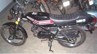

anyone ever play with one of these?

looking at installing a CR80 dirt bike engine, it fits right in and has 16.5 hp, vs 7. need to make a cylinder head mount is all, and install Mb magneto onto CR engine. once Oi'l injection system is removed bike will have more then double Hp and at least 10 lbs lighter.

I have two MB5's, both black like the one you show. A friend has a red one and put in a CR80 motor, says its the worst mistake he could have made. Talks often about taking it back out and returning to stock.
Unless you plan to run on a track, I would vote no. Think a stock one is hard to keep on the boil and your speed up? It just gets worse with a hotrod motor. :wth:

Plenty of hop up parts available for the MB5/MT5. That engine is used alot for moped racing in europe. Hoping my AC50 with RT kit will be faster than them when it is finished...

well i got it. its real nice condition, less then 2000 miles. hunting a tank, battery cover, everything else there and nice, good compression, chrome is near mint.
