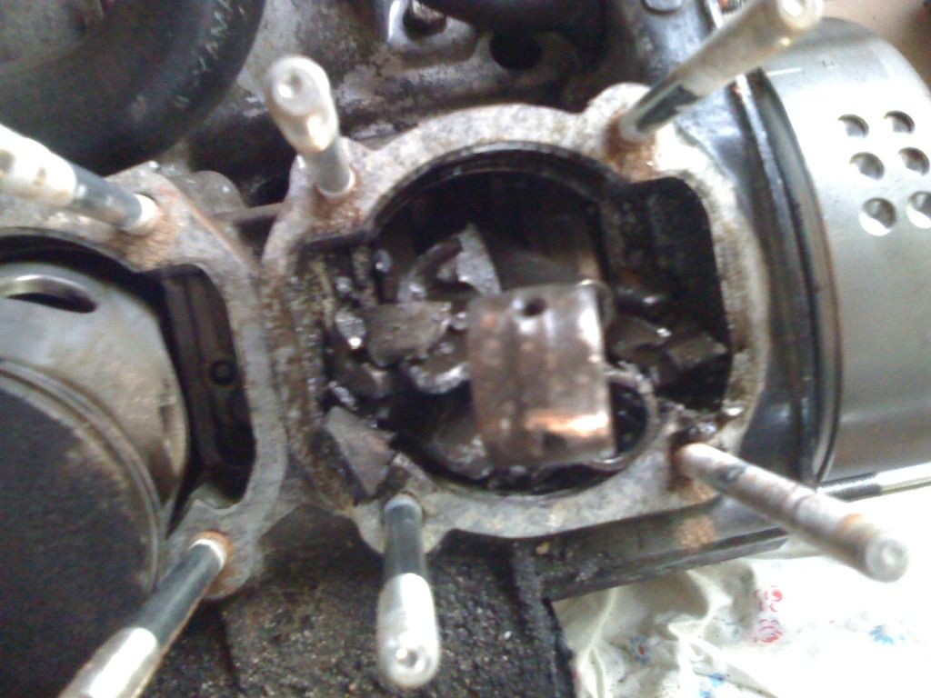

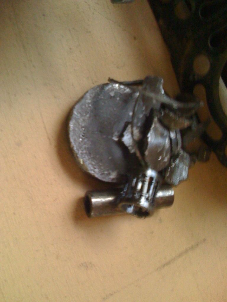

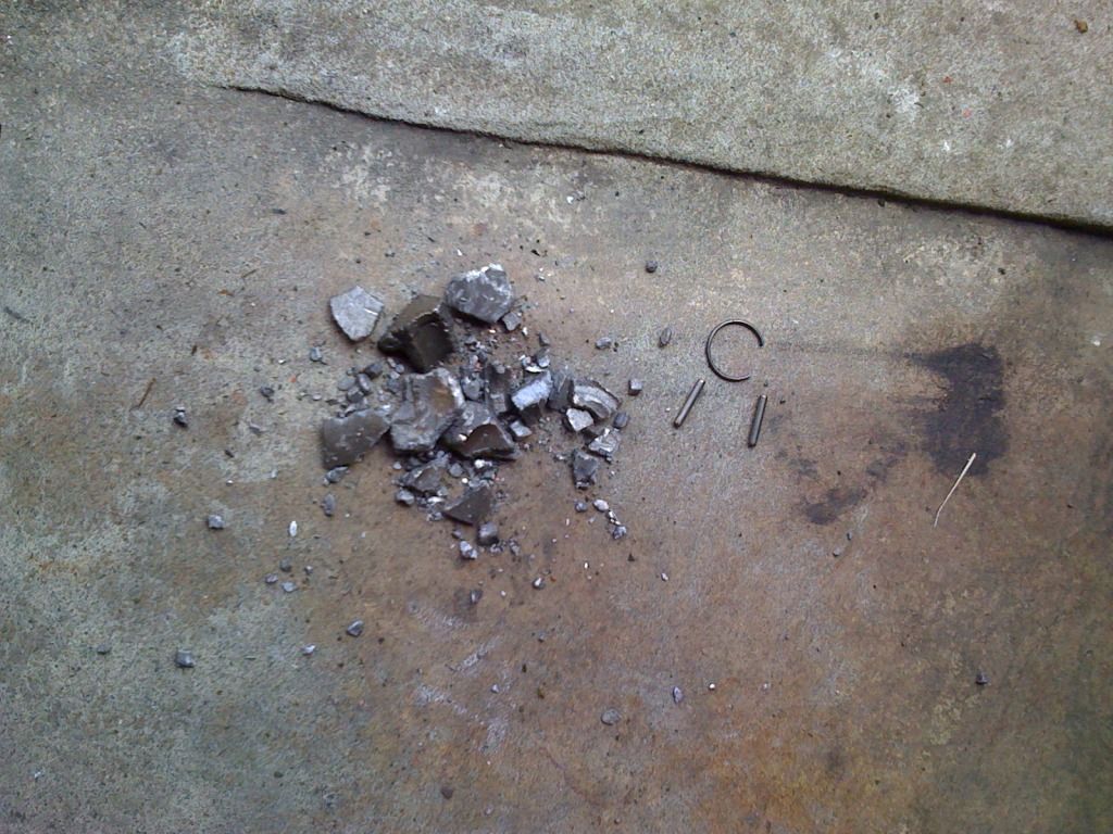

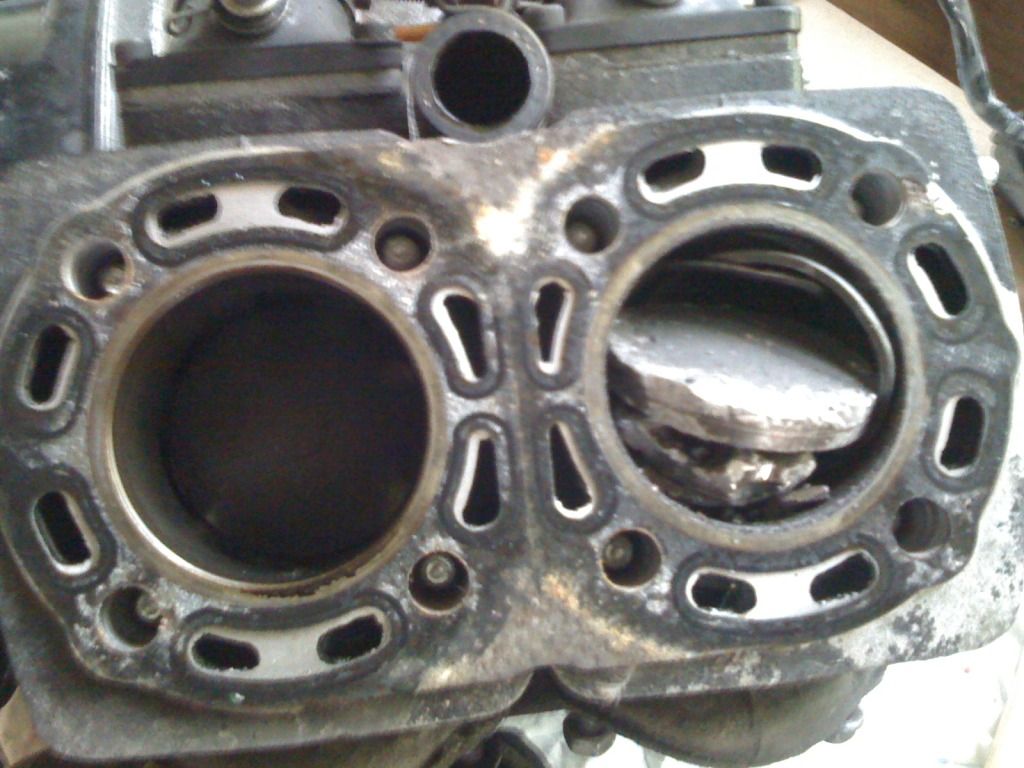

Here's a couple pictures of my RD350LC piston when it blew a crank seal and started sucking air. Warning, its not pretty. You'll have to excuse the poor image quality, I didn't have a good camera at the time.
This fell out of the exhaust pipe when I took it off
When I pulled the head I was greeted with this
and then this
These were the biggest pieces I could find of the piston......
So yeah, thats why I'm rebuilding the crank with new seals before even trying it....

dude99 wrote:it blew a crank seal and started sucking air.
Did you also take a picture of that seal you can show to see how bad it was?
I have run many engines with marginal to wasted crank seals. I have re-used old seals and I have replaced. It's all about how much in a hurry I am and mainly how good the crank is mechanically. If decide to re-use I am not expecting problems and so far so good. For me its bearings/rods that worry me the most and if in doubt I change these and then seals get changed at that point regardless. I try to get fresh OEM and stay away from old stock that has been setting on shelf unwrapped if possible. Same with old piston if they look "aged" I change. Else it seams to me they fail at skirts or eroded hole on top where plug is much faster than a fresh young piston would in its place. The next two things that freak me out is to make sure I am jetted correctly (fresh new OEM brass everywhere and always) and indeed the oiling system works. That should be check often. If ride hard I add a little oil in gas tank as premix. It also has saved my engine if something fails with oil system
Yes it's not cool to blow engines...

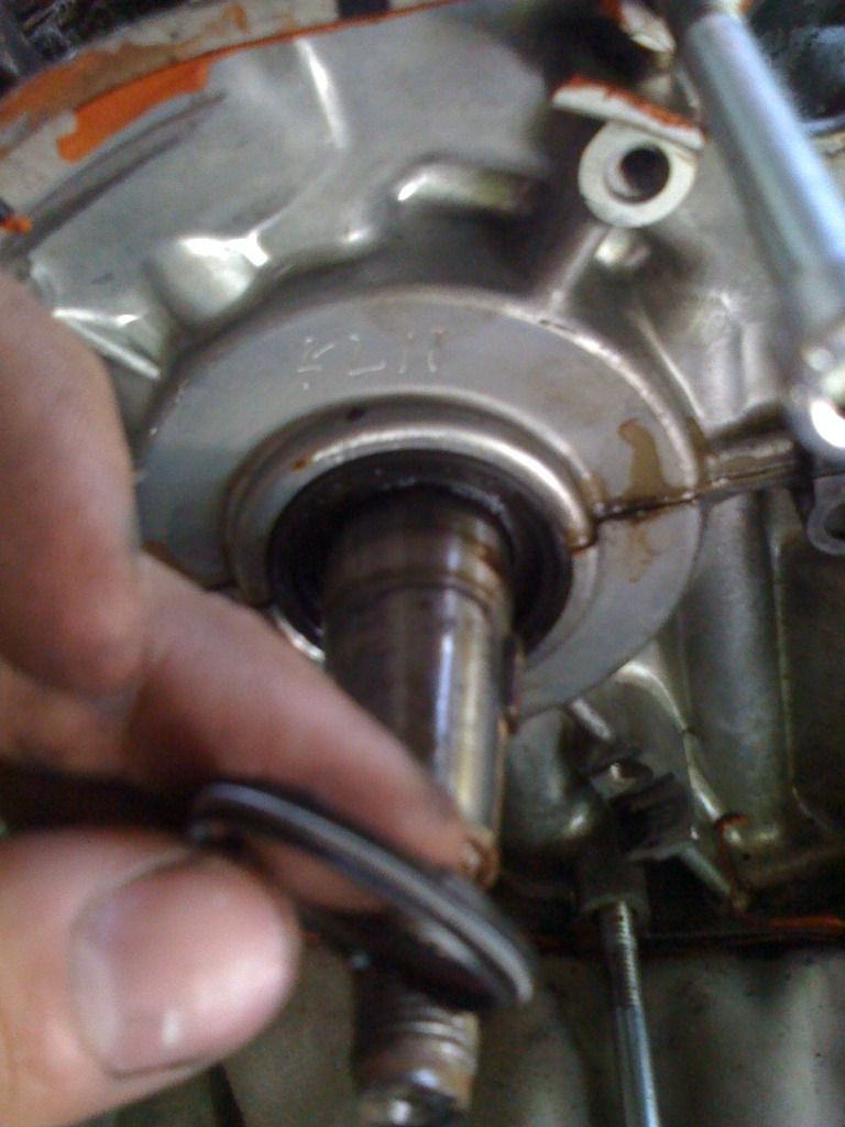

Indeed I did
I will never own a two stroke again that I don't replace the seals in....

Yup that is bad. How was the crank bearing? I have had that occur when the bearing goes bad and then seal goes due to slop in shaft and heat of friction (looks like the may be case hear maybe).
If the shaft has even a little movement that event can occur real fast once the bearing fails worse and voila melt down.
My point is sometimes the seals alone get a bad wrap when it is other items. Not that a seal can't go bad, I just find it more the case the crank had a mechanical issue as the root cause. Easy to check that in advance. Easy to test aif seal OK too. Oil pump or fee line can be root cause as well. Yup, sucks to blow and engine
