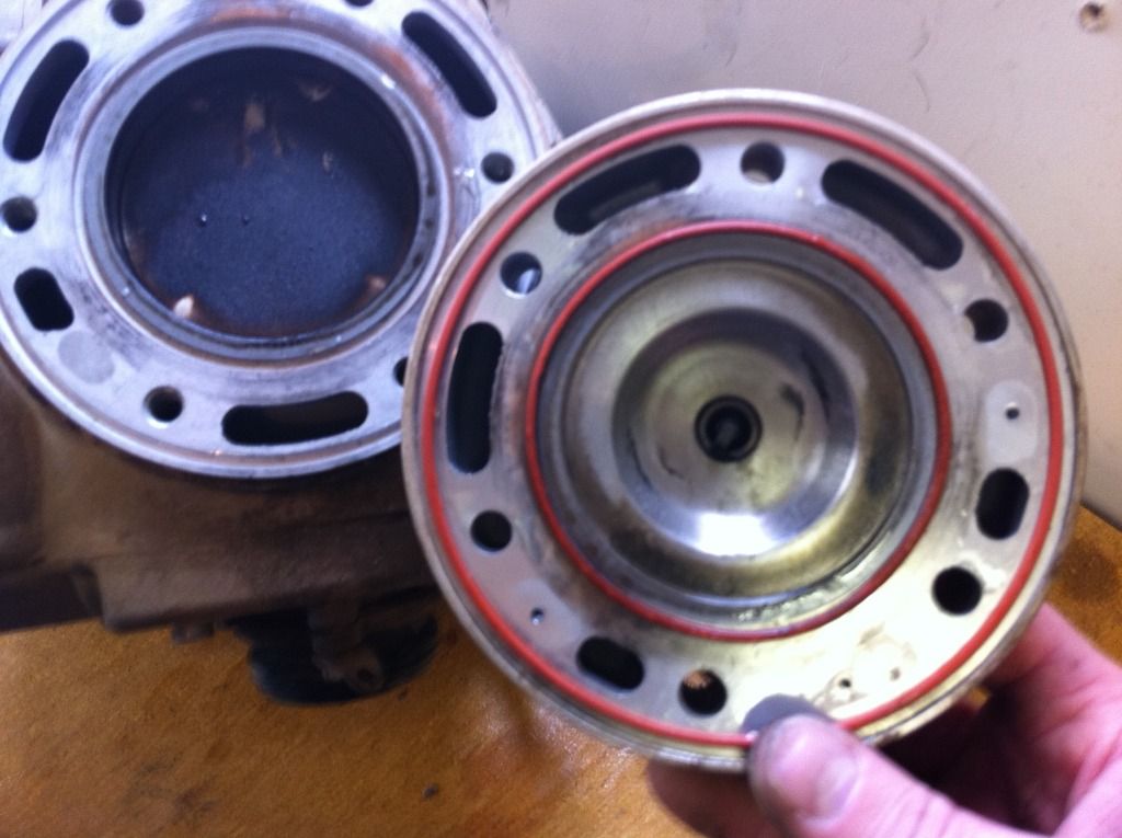

So here's some real life experience with 100LL in my 2001 KTM 250SX. I work in aviation so sumped 100LL is always free so I figured I'd give it a shot in my 250. The picture is after maybe 60-80 hours of 40:1 with Maxima 927 castor oil. This was strictly a woods bike so it saw it's share of lugging around the woods! Not one fouled plug all season!! Of course everyone said you can't run that in a dirtbike you'll foul plugs left and right with all those lead deposits, it doesn't run hot enough to burn it away, and so on and on....
Picture isn't that great but if you look at the head it was shiny. One of the cleaner topends I've seen for a woods bike. This was as removed no cleaning performed, picture was for all the doubters!!!
