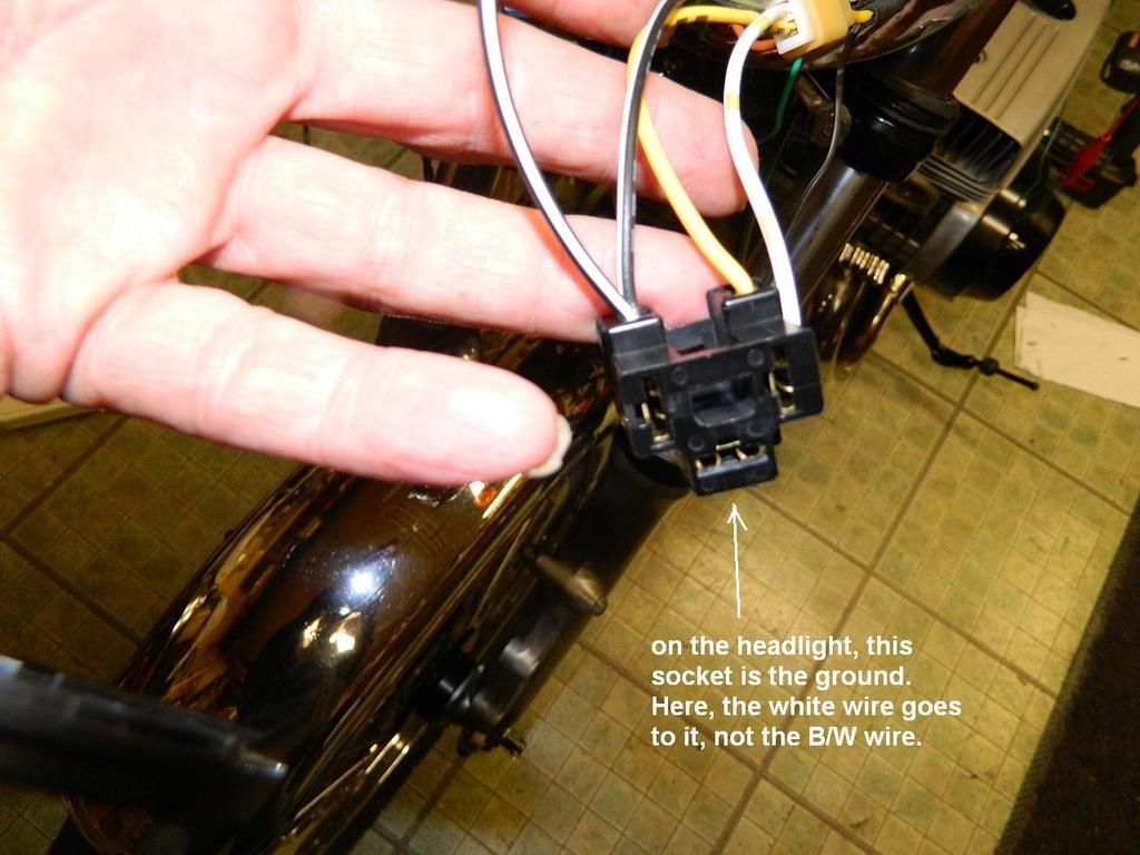

No front parking light. I didn't test the headlight yesterday because the shell is still open. I hooked it up anyway this morning. High beam works, low beam does not. Both beams work just fine when testing directly off the battery.. This is a 3 prong plug style headlight. When testing, I use the center prong as the ground and test the right and left prong to get both high and low beams. Looking at the headlight socket on the bike, the ground goes to the left socket, not the center. What gives with that? this part is brand new.

Scratch that photo and what I said about the headlight. The ground is not the center lug. Messing with test leads, I hooked it up the way the socket is laid out. Even though I go light before, low beam was very dim. Using the left lug as the ground, I get a nice bright low beam and an even brighter high beam off the other 2 lugs. So the socket wiring layout is correct. Still when I plug the headlight in, I only get high beam. It's bright and the high beam indicator light on the gauges lights up
Switching to low beam, the lamp simply goes out. I don't think it's shorting as it is not blowing the fuse. It act more like there just isn't any power in that wire. I must have something crossed somewhere. I always pay special attention to all my ground connections so I don't think I have a grounding problem. I am going to use my ohm meter to figure out which wire is dead in the circuit. It's either the yellow wire or the white one.
Just checked. It's the white wire. Using the engine as the ground, The yellow gives me 12 volts in the high beam position and just floats in the low beam position, The meter just floats in either position checking the white wire.
