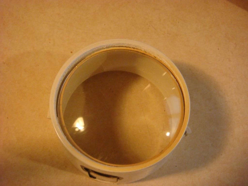

You can turn this
into this
I takes about 2 hours and several grades of sopping wet paper. Start with 600 and work till it's uniform in texture. Then go to 800, 1000, 1500 and finish with 2000. Each time you change grades tou need to sand out the previous grade, making it uniform each time. This is all done by hand. Do not use power equipment or you will melt the plastic. Just semi-firm pressure with your palm Change the water with each grade so as not to pull in any grit from the grade you just finished with. Keep it very wet and don't try to rush it. Your results will be the same as above. One thing I did do at the end was use plastic and plexiglass scratch remover. Got it from autozone, but most auto stores carry it.

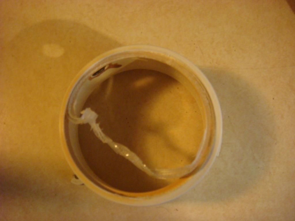

into this
