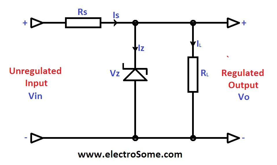

Can anyone help me design a voltage regulator
I assume the circuit is a simple as this:
I wasn't sure what ratings etc I'd need for each component.
I want to try one for the T500.

Posts: 4311
Re: T500 electrical...
A better & easier solution would be to upgrade to a modern rectifier/regulator like the Tympanium.
You'll get much better voltage control than with a simple zener diode voltage regulator.
For more info see:
viewtopic.php?f=2&t=4858&p=109480&hilit ... um#p109480

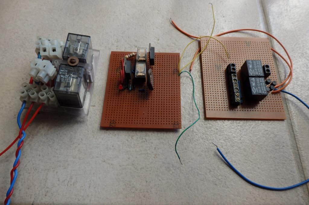

My other hobby is model subs. Here is a photo of the 3 control boards I did. I needed a circuit that would allow one channel of the RC gear to control 3 things (operate air release to ballast tank, operate water pump or start air compressor).
The first one (on the left) I rewound a could of 12 volt relays so the coils were 6 volt. Then I thought I'd use transistors. Too much voltage loss. Went back to smaller relays and used smaller transistors to do the switching. My mates mocked me and said use an Arduino or upgrade my RC gear. I like to do things my way...stubborn all the way.
With me it is the journey...

It's certainly OK to make your own. The T500 electrical system is pretty basic (wouldn't want to do it for an electromagnet alternator).
A couple things to keep in mind --
The stock regulator hangs on the input side of the rectifier (across the alternator output) and not on the DC output side (across the battery). So it is regulating AC, not DC. Also, be sure to size components to handle the amount of current it may potentially see.

Typically voltage regulators are connected on the output side (DC) of the rectifier. This will be the vast majority of circuits you will find on the Internet. The T500 has an AC voltage regulator, which is on the input side of the rectifier.
The AC regulator is a bit more complex, but has the benefit of generating a bit less heat, so smaller components/heatsink is required.
