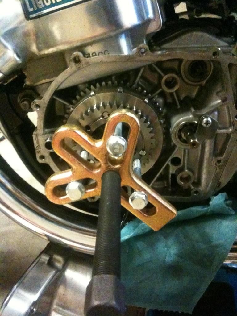

Took the cover off tonight and does look like the gear has slipped. I will pick up the steering wheel puller tomorrow night.
I can see swarf and it looks like the keyways are not in alignment.

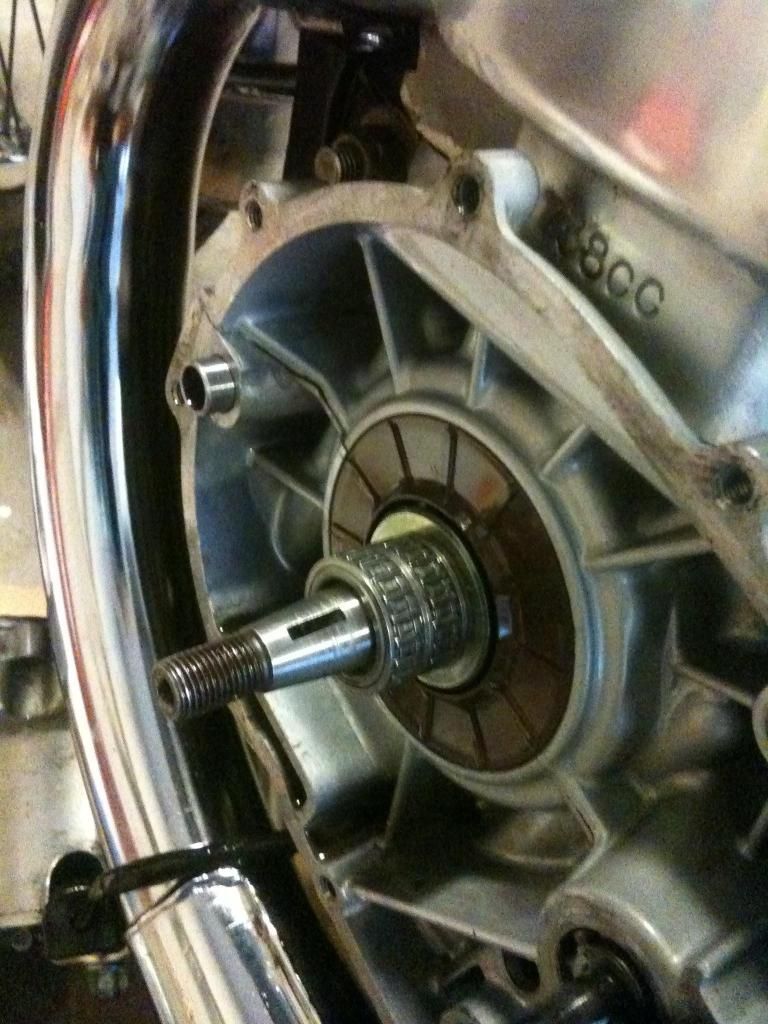

Had to source a puller here in Kanadia; picked-up a harmonic balancer puller from a auto parts store.
Key is sheared in two. I also suspect a leaky petcock. On my T500 after rebuilding the petcock I ditched it for a Pingel Dual Outlet w/ On/Off/Reserve. Looks better too!

I edited your photo links for you.
