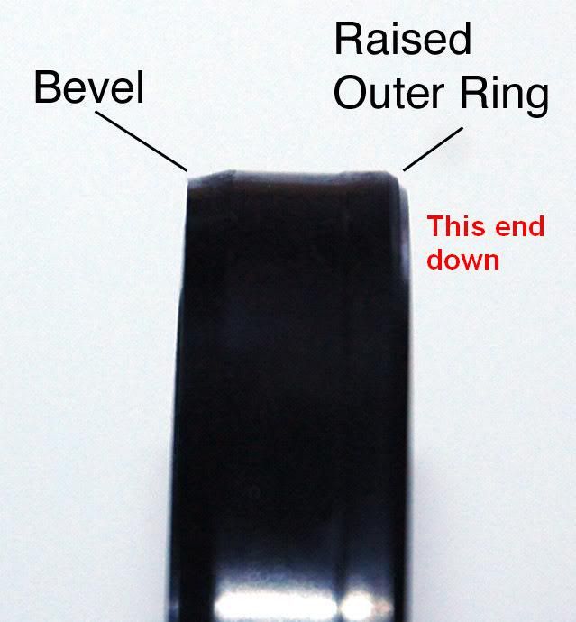

Are you sure you are putting them in right way around? Fork seals are deceiving (at least the ones I have used). There is a small step on the seal OD. That small end looks like a starter diameter but it's not. If you are putting the smaller end down, they are upside down. I have made this mistake myself.
OEM fork seals are no better than many other seals on the market. Originally the seals were 14mm tall. Later the seals changed to 11mm tall and the difference was made up by a 3mm shim. I never saw those shims as they were probably lost by a previous owner. I just pushed the seal in to the shoulder in the fork leg. Never had any problems installing them that way. Hope this helps!
