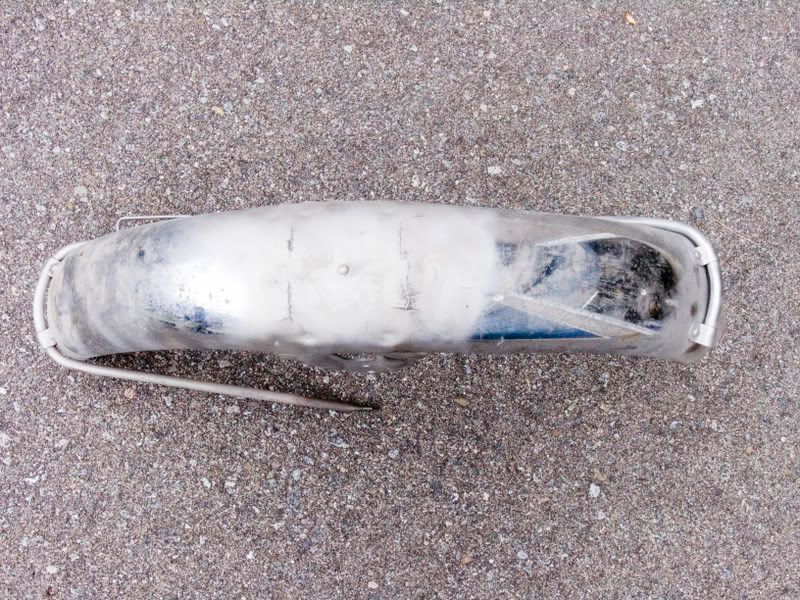

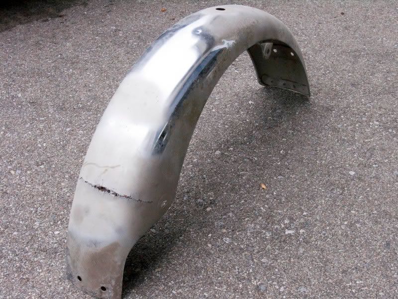

Fenders
Tin worm on the rear fender
and on the front fender
I've started an album at http://s35.photobucket.com/albums/d164/ ... ki%20T250/
