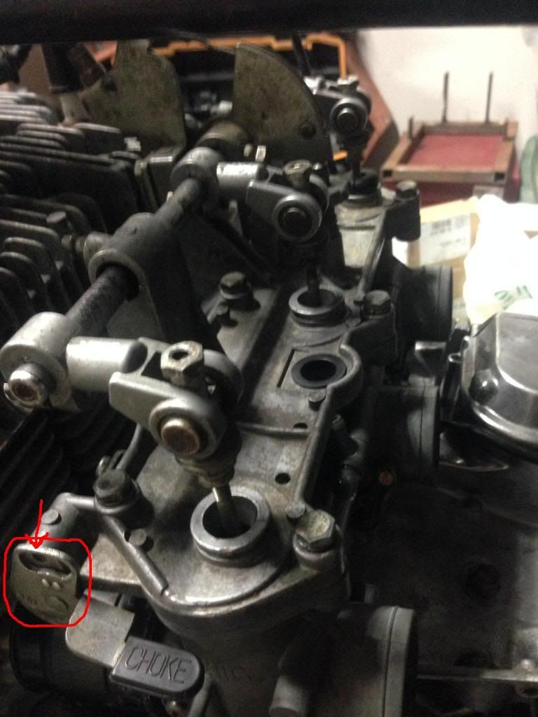

Do you have the ball and spring? There is a shallow detente in the choke lever. The spring loaded ball is what holds the choke lever in place. What 'screw' are you missing?Carb choke (missing screw, wont stay in choked position)
Mine has the choke lever, but no way to keep it in the "start" position, I guess because I am missing some pieces for the lever position. Here is a picture of what it looks like so you can see what is missing. This is my first experience with these bikes so I'm sure what all is missing.Coyote wrote:Do you have the ball and spring? There is a shallow detente in the choke lever. The spring loaded ball is what holds the choke lever in place. What 'screw' are you missing?Carb choke (missing screw, wont stay in choked position)
There are several small pieces in the choke lever assembly. A shouldered large head main screw, a short nylon spacer sleeve, a washer and a lock washer. Plus the spring and ball. I think I have a spare spring and ball if yours are missing. A spare lever as well. Sadly, none of those choke pieces are available, so you may have to improvise on some missing things.

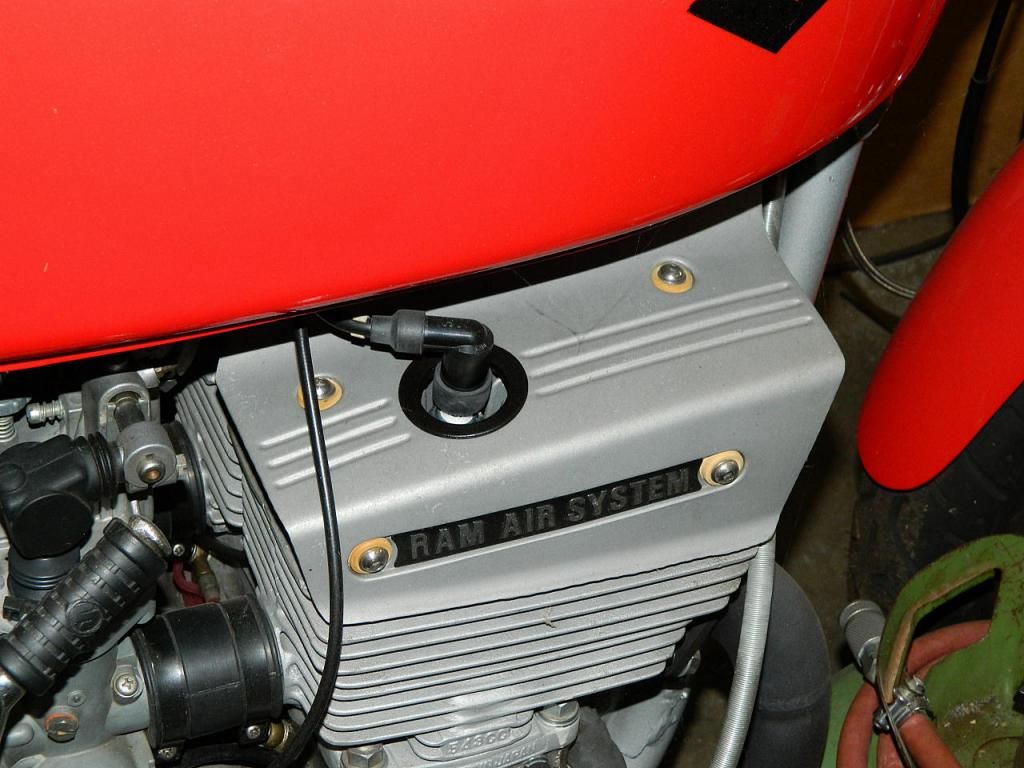

Look for "cable bushing" at your local electronic-parts-dealerDoes anyone have a good idea where I can buy grommets of nearly the same size diameter and thickness that are installed in the Ram Air
