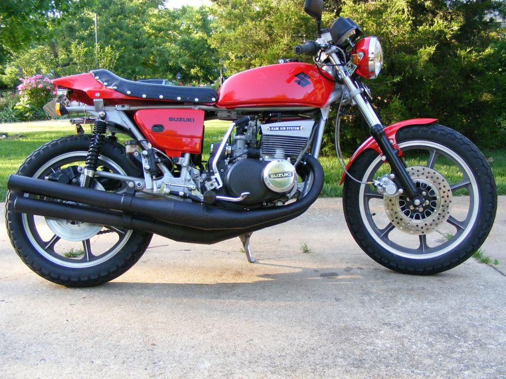

Experimenting with a KZ550 gas tank. A PO did a crappy Kreme job and I have a couple extra Kawasaki tanks. I prefer the Suzuki tank on the Suzuki though. I might try it with the Kaw seat and tail though...

That doesn't look too bad at all.Maybe it's the shape and maybe it's the bright shiny look versus flat black.

Tank looks good on there. More aggressive stance then the rounded GT tank. If you change, I claim dibs on your GT tank. :up: . Been looking for another tank (and side covers) for a while now. My body set is too nice to forfeit, but I want my bike to eventually be white. Just like RedZone only white.
