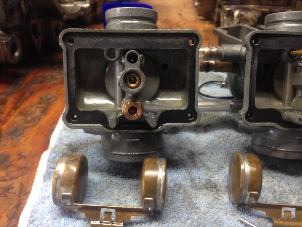

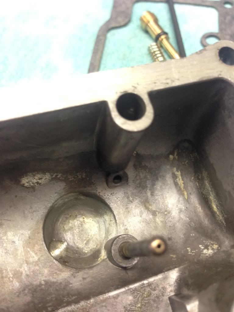

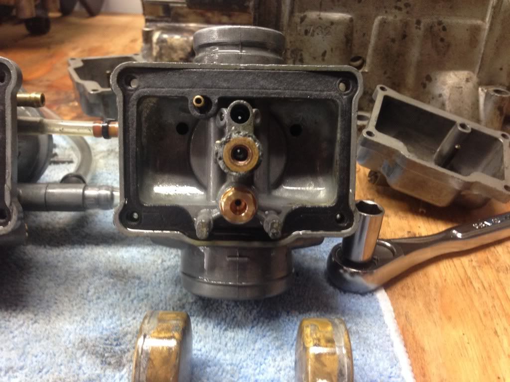

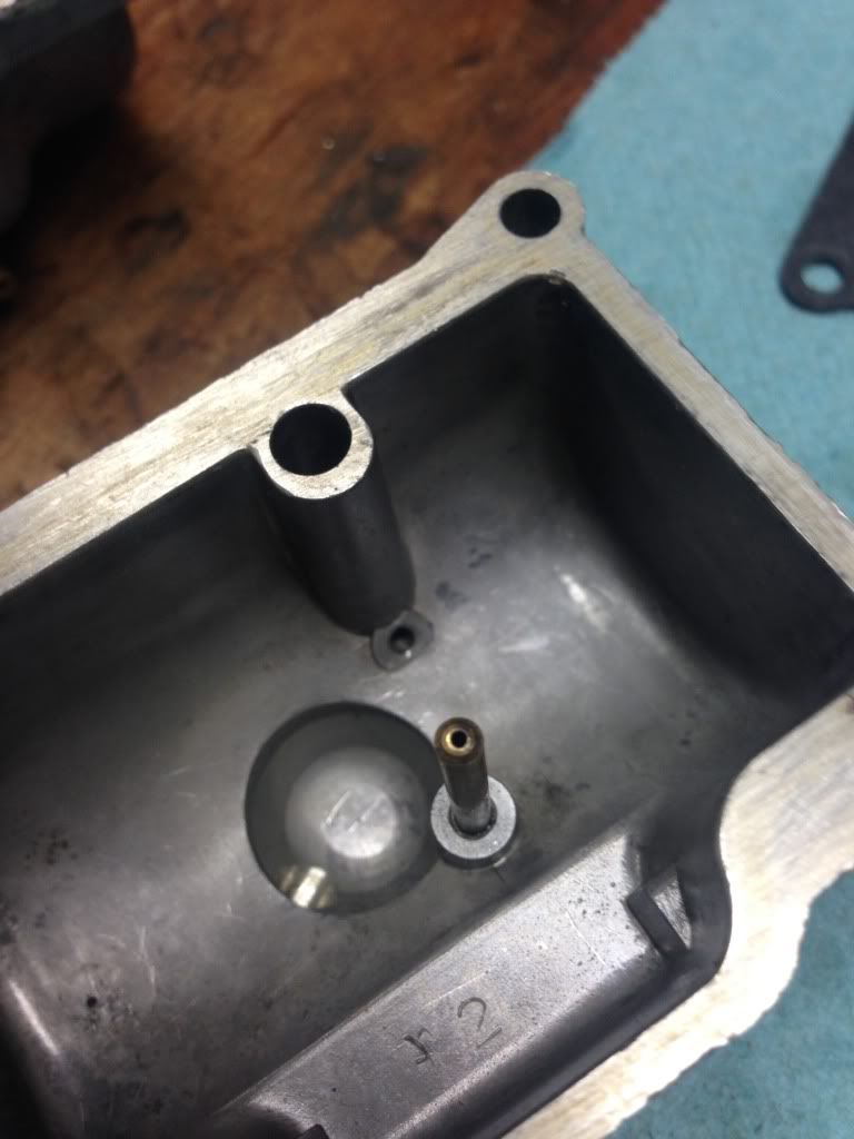

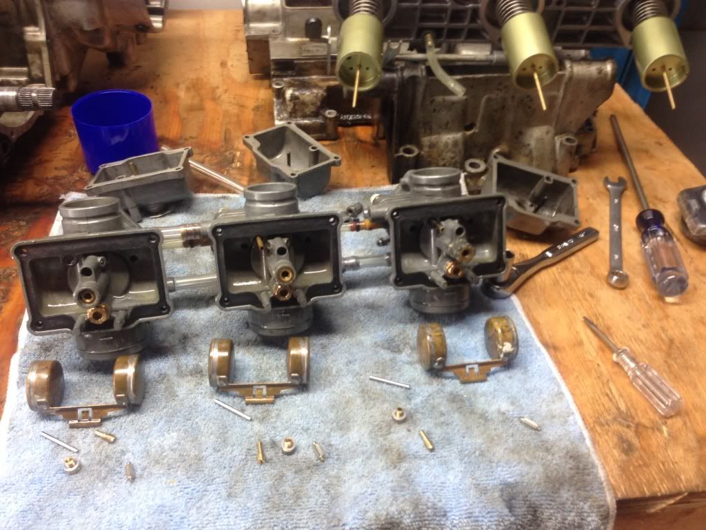

So I spent the whole day taking my carbs apart, cleaning every part with spray carb cleaner, dried with compressed air, then reassembled them. I found that the passages in the float bowls that are a part of the idle system were still a little gunked up, so I cleaned those out better until they allowed passage freely through the system. I reset the float levels and put everything back together.
These are the passages that were still a bit clogged, the ones in the upper portion of the pic.
