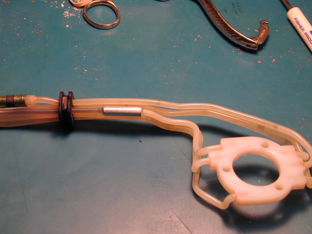

It's quite possible that crankcase compression pressure is being allowed up the line because the check valve is stuck open. Be very careful when servicing those lines!
Re: GT550 oil pump
And Never EVER use compressed air!
Remove the pump and the manifold beneath the pump. Remove all 6 banjo bolts. Put one of those bolts in your pocket and head for the hardware store. Buy a nut that fits the banjo bolt. Now assemble the banjo bolt (with a sealing washer on both sides) in the check valve end. Put on the nut and tighten. All that is left exposed is the hole in the banjo bolt the goes into the motor.
With a syringe, oil can or other, try to force a little fluid in the open end of the bolt.. If fluid flows (I use alcohol). the check valve is definitely stuck open.No fluid should pass in that direction.
I have had some luck freeing up the valve by passing lots of alcohol through from the manifold end. Rap the valve against something hard to try to dislodge the ball. Continue with the alcohol. If that doesn't work, you need a new manifold. Naturally these are no longer available. I have been known to splice on another line with a known good check valve. As these lines are formed, you need the same line from a donor manifold.

Last time I tried that, the alcohol was not mixing with the oil at all well, so I reverted to using degreaser first to emulsify the oil and residue. I flushed that out with WD40 and flushed that out with two stroke oil. I use a simple old hand held oil can to push liquids through the lines.
In one case I had to repeat that several times, but as Coyote mentioned, do not use compressed air. The air pressure pushes the ball up into the spring and it cannot seal after that. This is from a check valve I opened up that would not hold pressure and leaked.
