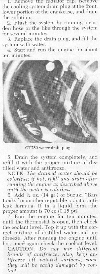

I wasn't implying that I have a leak nor would I use additives in any of the fluids unnecesarily. I suppose it got misinterpreted because I posted in the "Repair" forum. I was referring to the service manual which indicates Bar's Leaks was added at the factory and says to add it when changing. I certainly won't be adding it to mine but just curious about Suzuki's motive and other owner's experiences who chose not to add it during service intervals.
Re: Cooling system maintenance
Bar's Leak was specified in the shop manual (page 62 in the one in front of me, or also on line at this link). I only bother with it on the first radiator coolant fill after an engine rebuild. When just changing the coolant I don't bother. 8)
note item 6

I think the idea behind it was --- should the radiator develop a pin hole (from a rock or whatever) the Stop Leak would seal it before it became a major problem. That's just a guess.
Coyote wrote:I think the idea behind it was --- should the radiator develop a pin hole (from a rock or whatever) the Stop Leak would seal it before it became a major problem. That's just a guess.
I'm of the same opinion as well Chris (and I like your footer by the way ! :up: ) . The other thing was that the shop manual was written for the J and not really updated much afterwards, and in the J you don't have the o-ring seal on the water bypass line between the crankcases that was introduced with the K's. Just a 'belt, braces and hanging on to your trousers with both hands' engineering approach. 8)
