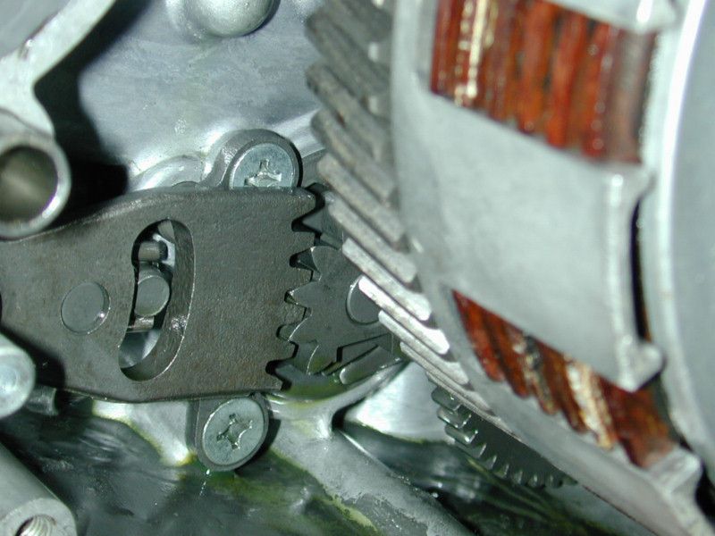

If it has been this way since you got it, this is the most likely culprit. Put the bike in neutral. Remove the clutch cover and look at this gear and paw. The gear and paw must look exactly like this in neutral. If it's out a tooth, there's the problem. You can fix this situation easily. Just pull the forward most gear toward you and align the gears to look like this -- then just push it back in proper position.

All the orientations are the same, the location of gear and paw are as shown in your picture. I also didn't find any broken piece.
