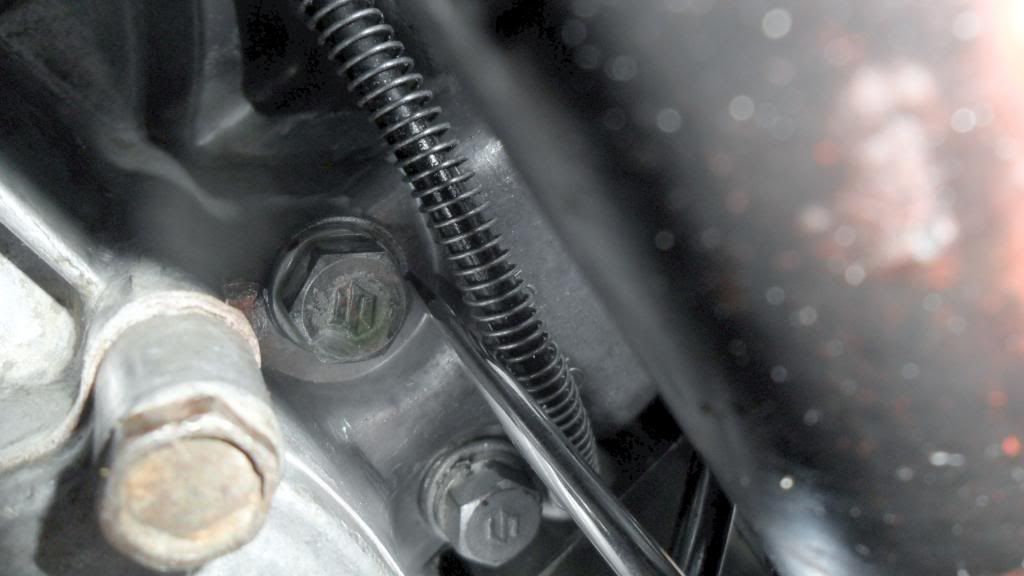

It actually drips from the crankcase bolt. I have looked at the feed lines for leakage and ALL dry even the area around the starter is dry.
Over night it stopped dripping.
I go for another ride and again there is a puddle under the left side and it drips!
Crawl underneath and yet again it drips from the Bolt.I move the SRIS line out of the way, wipe clean, still drips.
Put cloth next opening on Cover where Left SRIS line go in. still drips..everything above the bolt is dry. The left SRIS valve is dry.
I am stumped as I find it impossible for a crankcase bolt to leak fresh injector oil.
No leakage at the pump side.
Ideas?
Pics of the area.
you can see oil on the head
