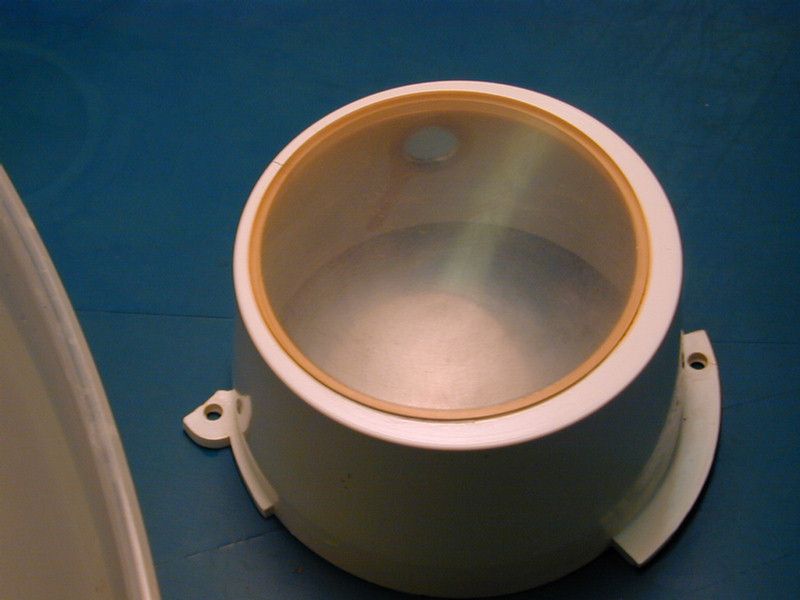

Sandpaper. It's the only way. Here is a particularly nasty gauge. Can I fix it?
I removed the speedo from the housing. It was so bad I had to start 320 grit then 400 Here's how it looked.

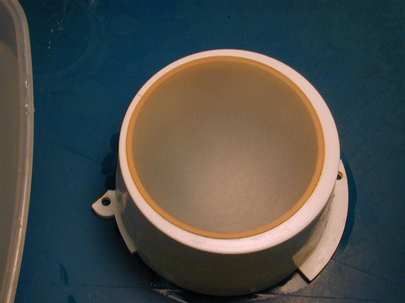

Then on to 600grit, 800 and 1200.
Finally on to 1600 and 2000.

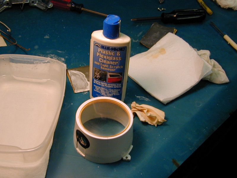

From there I used plexiglass light scratch remover and polish. Rub, rub, rub with a damp cloth.

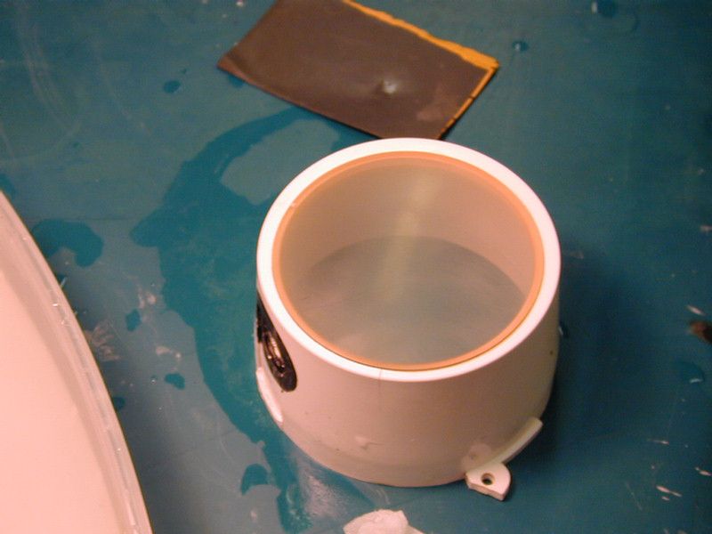

Yep. It's the same one. Clear as new !

Wow, thanks Coyote. I assume the steps would be water and the light grit sandpaper ? Then a soft cloth and scratch remover of your choice ? I'm gonna give that a go this winter.
Re: How can I fix yellowing gauge clusters ?
Yes. All sanding is wet. You can see the tub of water in the next to the last pic. Change the water with each decrease in grit.
