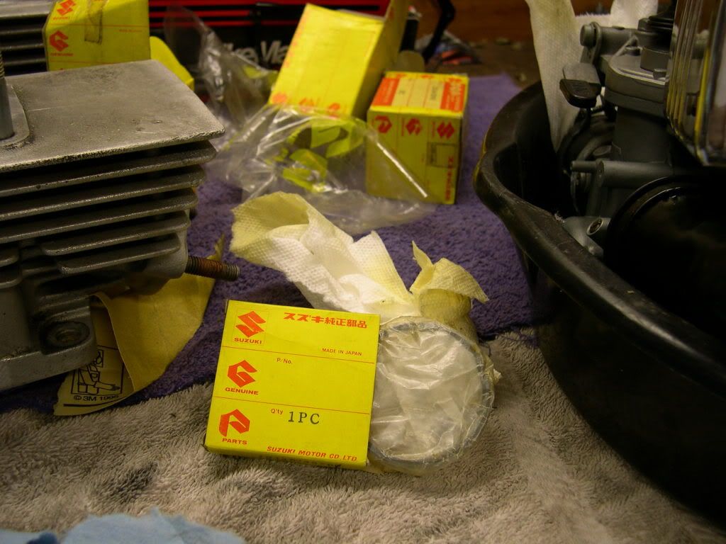

I have new Suzuki pistons and rings. The rings came together and undisturbed, had to work a little to separate.

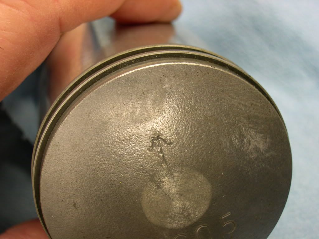

The issue I wonder if others have had is a few of the rings are too wide to fit in the groove. The rings stay stuck unable to compress in. I thought it was the pistons at first but the rings that work do so in all of the pistons, the others do not.

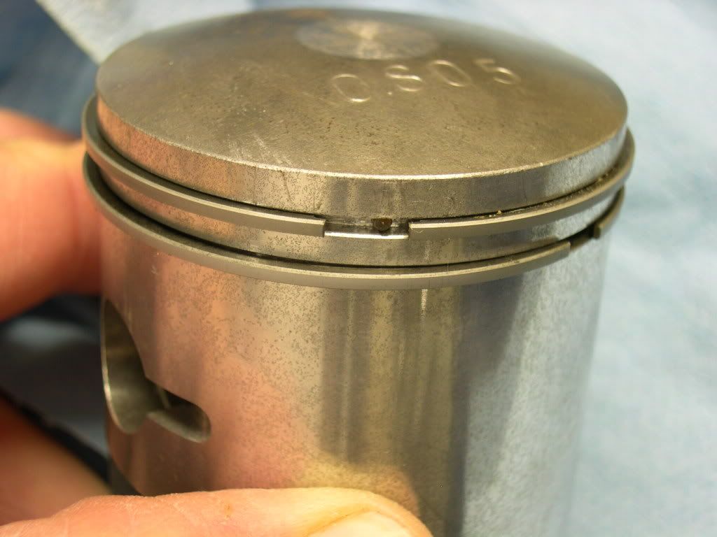

I hope you realize that Suzuki used "Keystone" rings. On some pistons, only one of the rings is a keystone. The keystones are not square, but are triangular-shaped, and if put in a square piston groove, they will stick.
rngdng wrote:I hope you realize that Suzuki used "Keystone" rings. On some pistons, only one of the rings is a keystone. The keystones are not square, but are triangular-shaped, and if put in a square piston groove, they will stick.
http://kawtriple.com/tripleed/dalegt380/sm20.jpg
I'm betting thats your problem. Both rings on the 550 are keystone type and only the top ring on the 380.
When I rebuilt my 550 last year, NONE of the rings were lettered or marked in any way. I had to use high magnification and a true straight edge to determine the beveled side. A jewelers loupe works good.

I knew they were Keystone but thought they were All Keystone. Maybe I am trying to put a square one in a keystone angled groove if they are angled.
The bottom ring is okay in the photo, just the top ring is the issue

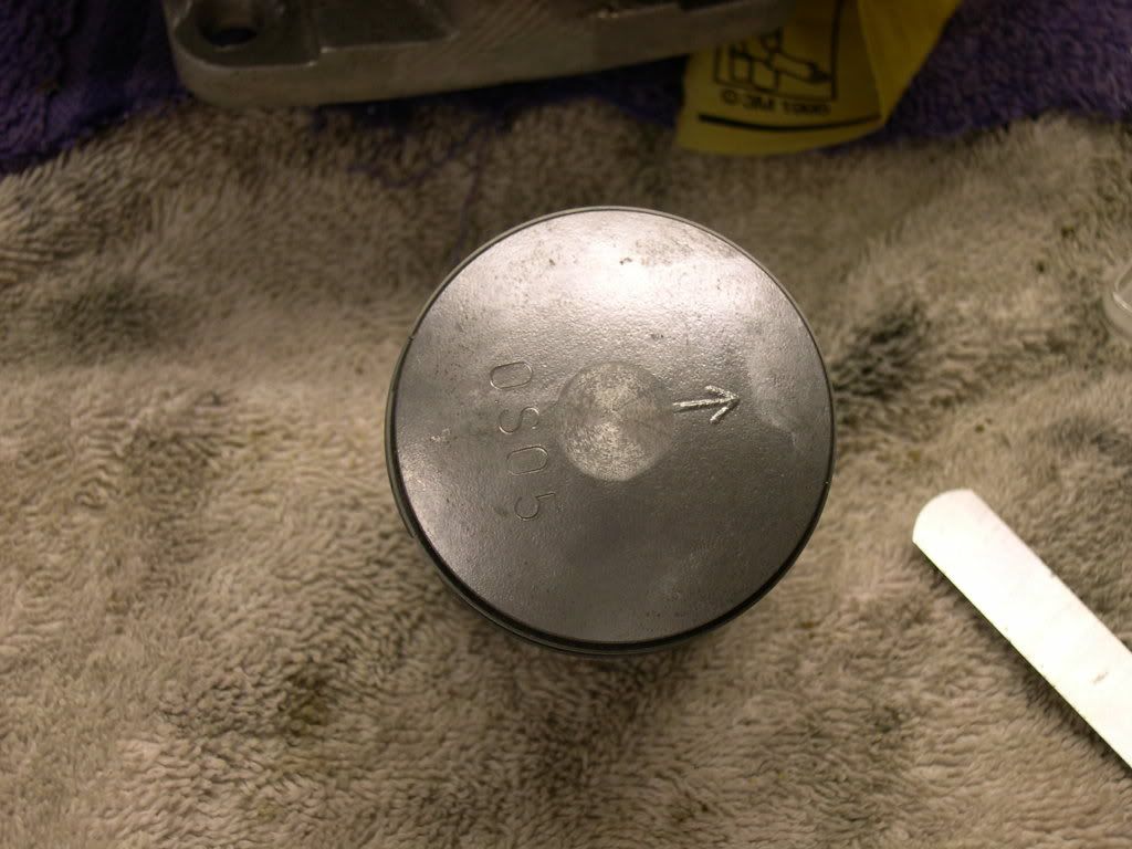

1. The pistons seem to have square grooves.
2. I don't have an accurate enough mic for a good measurement.
3. The 3 rings will not work in the top or bottom groove, markings are facing up.
4. Tried the 3 rings in my old pistons, same result.
5. My old pistons seem to have square grooves also.
This is a 75 GT380, could they be different than other models? I am not sure where to go from here.

Tim, what pulls up for the ring number with a zero at the end as the zero was changed with a pen? I sent Craig380 a PM to see if he can shed some light on this.

I've re-ringed my '76 380 twice -- in 1999 when replacing a failing rod end bearing, and again in 2007 when I rebuilt the top end with a good used set of pistons and cylinders.
Both times, I had no problems with ANY of the rings sticking in the piston grooves. All rings & pistons were genuine Suzuki. And ALL the rings I got were of the keystone type, with a tiny letter indicating the top surface of the ring.
Now, the caveat here is, I was fitting new rings to used pistons. Maybe the ring grooves in the pistons were a little worn ... I don't know.
I was super-paranoid about putting the rings in the wrong way up, and ALL rings had angled top faces, I checked this.
Now, I must admit I always thought both top & bottom rings on each piston were of the keystone type.
All I can tell you is the bike has run great with (apparently) mixed rings for 10,000+ miles.
One thing is did notice -- the ring 'cutouts' that fit the locating pin in your photos look a LOT shallower than the cutouts on the rings I have. I will have to check when I get home.
Actually, another thought -- are you sure the rings you have are 0.5mm oversize?
I was lucky when I rebuilt mine last year, I'd got a collection of 0.5 oversize rings which were ideal for the piston / cylinder set I got.
Suzi did make oversize rings to suit the oversize pistons and they had different part numbers -- I'll have to check my parts book for the numbers.
