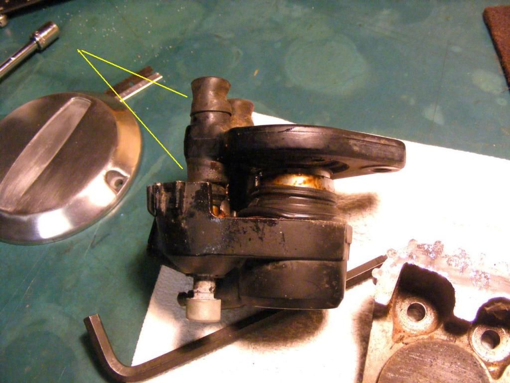

Re: GT750 front brake caliper rebuild - HELP
The boots go in both sides of the center 'carrier' part. Some guys omit them as they are just dust shields. Not me though. This was early in my last rebuild
