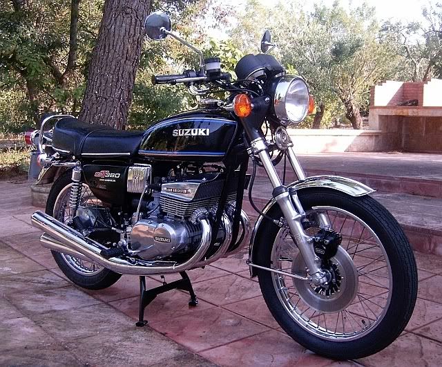

Just got myself a GT380 which I'm told is a B model. The guy I got it off has done well part restoring it but he stopped part through the paintwork, The red is on but still needs the decals and lacquer. I have the decals here from Sunrise Graphics. They are 4 straight double lines of red/black. Spent ages on the net looking for a good size piccy for my paint guy to refer to. This is the best I came up with.
This one will probably do but it would be great if someone has a close up view of just the tank and a black (cci side) side panel please it would be a great help for him Also to confirm that the red/black stripe is correct.
