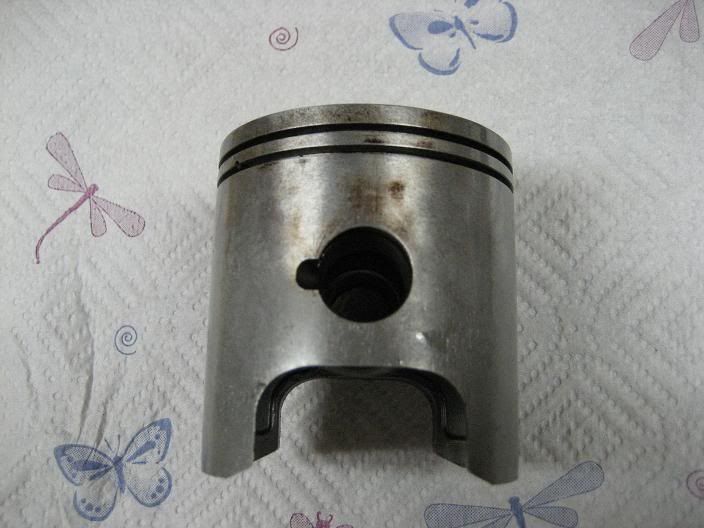

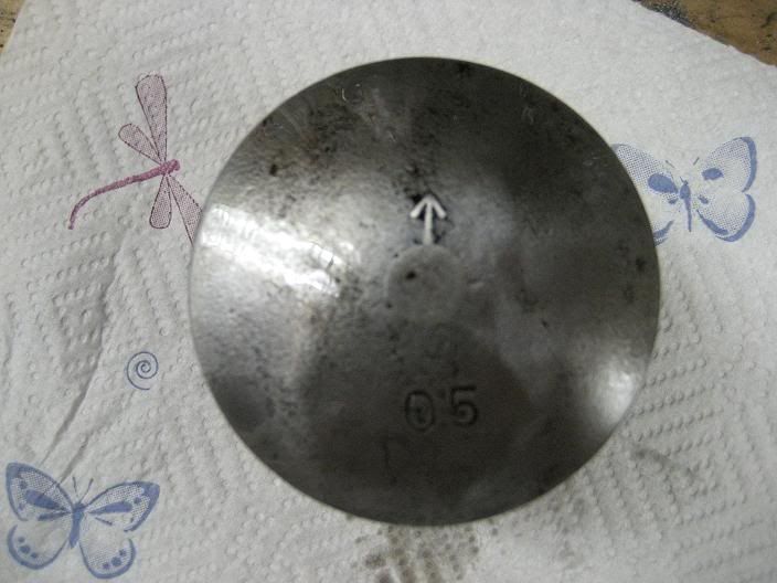

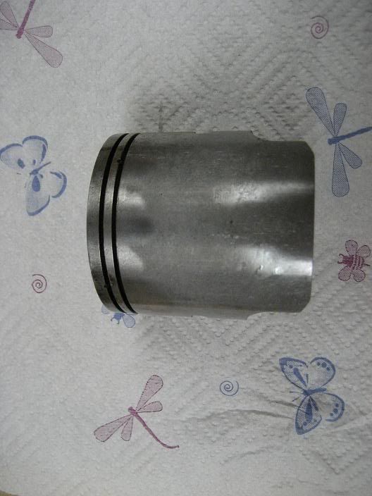

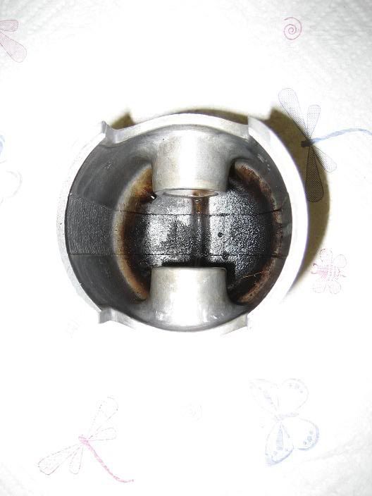

Jug...here's pictures of my '73 TS250 0.5mm oversize piston. I'm looking for a 1.00mm oversize for a rebore...
The top of the dome is ~1.5" above the centerline of the pin and ~3.25" above the bottom of the skirt.
Let me know if you have anything in your stash...
Thanks!

Well Chris it doesn't look Like I'll be able to Help.The one Pictured is Only 63mm.I figured I would Copy cat you though. :lol: :lol:
