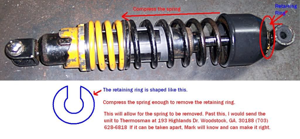

does anyone know how to rebuild shocks? I won a pair off ebay and when I received them noticed one is covered in oil. The seller has been very helpful but doesnt know the brand for a seal kit. Figured at 13 1/2" they would be great for the new and improved frankenbike.

The problem is finding the rebuild parts. I have a set of TS400 shocks that can be taken apart (I have...) and I can't find the correct seals for them. They're a really odd size, 12.5X23X12.

I was planning on taking them apart to paint anyway but dont have a clue how to do it. Never had to do it and dont want to get them apart and not be able to get them back together... :? :?

Most shocks don't come apart. If there's a threadded plug around the shaft, they can be rebuilt, IF you can get the parts.

Kinda looks like a weld peeking out behing the spring there at the area where the shaft goes in,if so,then they're not serviceable.
Looks like a good set of springs though,don't chuck 'em.
For 100 bucks are so the Old Bike Barn/JCWhitney cheapy shocks work ok,Mine are pretty damn stiff for my T500 but they have the proper damping for the spring rate so the handling is world better than the OE shocks.

John, here are the images for what we discussed over the phone.......

Ahhh, yes pics are worth 1000 words Tim, thanks.

Oh, you wanted to get the spring off? Sorry, I was thinking of taking the damper apart to replace the seals.
Tim, do you think your shock contact can get the weird-sized seals? I need a couple of 12.5X23X12's to rebuild the original TS400 shocks.

My T200 rear shocks have very rusty nasty springs. They need rechroming big time. What's the correct tool to use to compress the springs to remove the collar? You can bet I don't have one here, whatever it is. I know a car spring compressor would be too big, but is there anything out there for a bike?

I use four "S" hooks from the hardware store, and two turnbuckles, also from the hardware store. Put two s hooks at the top of the spring, and two at the bottom with the turnbuckles between them. Tighten away. In some cases (short shocks/springs) you may have to attach the turnbuckles and lower s hooks to a bar through the lower mounting hole.
It's a 3-4 dollar tool, and it ain't pretty, but it works.

rngdng wrote:Oh, you wanted to get the spring off? Sorry, I was thinking of taking the damper apart to replace the seals.
If it can be done, Thermosman can get it done. Give them a call and I'm sure they can set you up or tell you where you need to go to get what you need.
