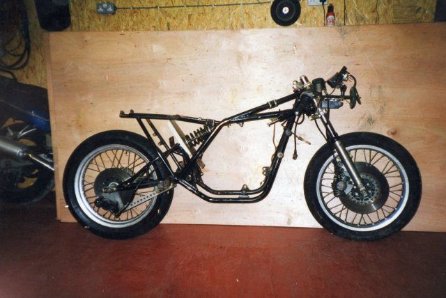

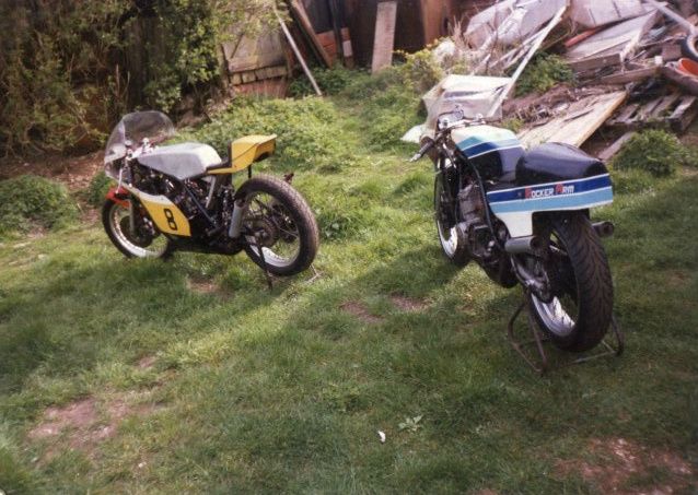

Re: Water cooled 500
I don't know if it's one of john's,But it's not one of the pair of watercooled ones,They were both monoshock,This one is twinshock,The pic below is of the pair together,Mine is the one on the right, Also a pic of the other chassis.
