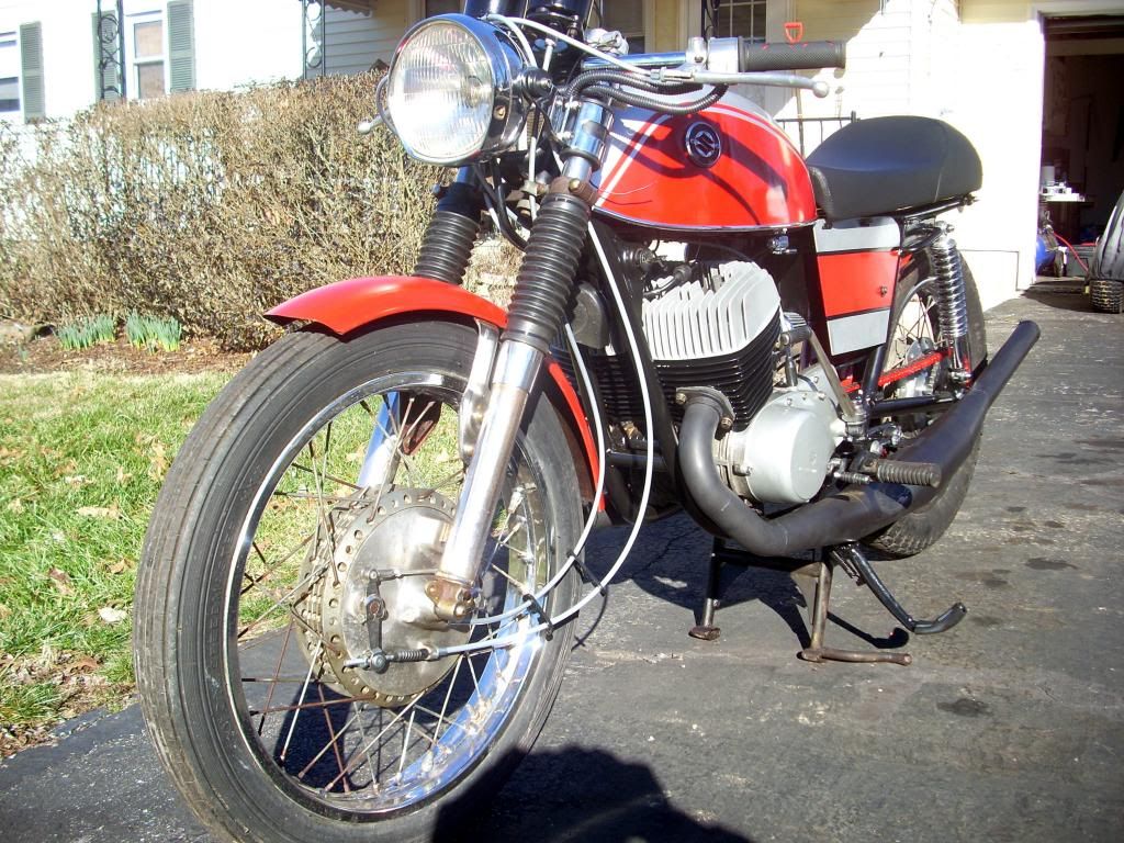

I have had my 69 T500 back together for a couple of weeks, and got it running ok, but new carbs not tuned completely yet. I did not split the engine and only did a top end refresh.
Any way the right side of the engine is leaking some oil from what appears the exhaust port. Anyone have a diagnosis? Right side crank seal? Any way I'm bummed out about this and hoping for a resonably painless fix.
Posts: 6210
Re: T500 Oil Leak from Ex Port
Some leakage is not unusual and means that you need a little high temp RTV to seal it. But the real question is why is there lots of oil. It may be the crank seals and you can check them with a leakdown test. It is also possible that the issue is a check valve in one of the oil pipes that may be stuck open. Remove the oil feed pipes and clean them out but do not use compressed air or the valves will be damaged.
BTW, what pipes are those? They look good.

Those are Jemco street chambers!
