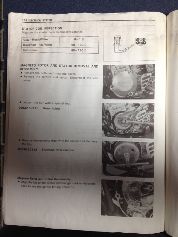

I have a 1999 rmx 250 and im trying to get it to run it ran previously but i lost my nerve a few weeks ago went to town on the excess wiring fir lights etc i would like to know the following
Black brown white from magneto
Yellow ×3 from magneto which go to
Rectifier
Also a picture of cdi from the top showing where wires all go into cdi
Im praying someone out there can help me
Kind regards mike

How about the entire electrical system section of the RMX250 manual??
If they are too hard to read, send me your email address and I will send them that way....
I can't take a pic of the CDI as I no longer have the bike.
