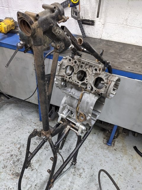

The rear upper engine mount..............

Joining the Kettle engine cradle to the T150 frame - right side rear................

and the left side................

awaiting welding.............

You've certainly got a helluva lot more patience and expertise in the metalwork department than I ever had.
