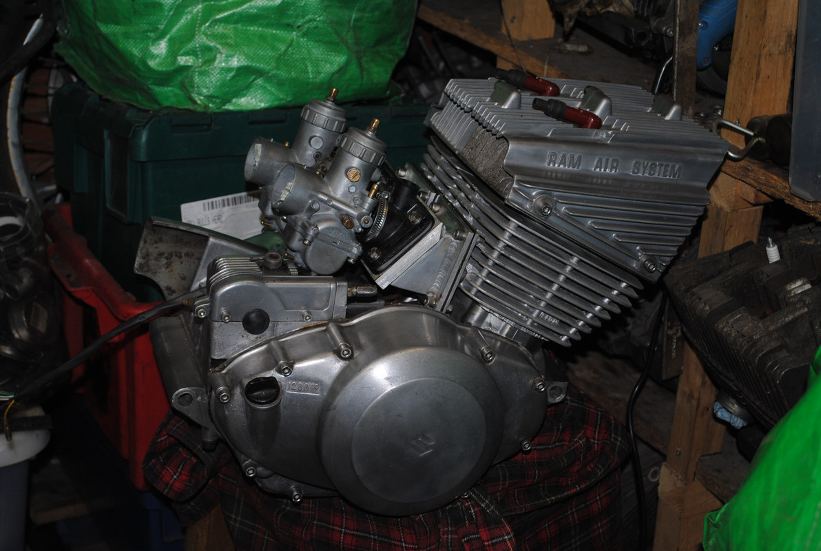

finally [nearly] finished the reed valve conversion for a normal t/gt250. can't try it yet, even though it's now in a frame and all piped up with fuel and oil. haven't got a throttle cable, so i've got to wait for that, and the supplier sent me the wrong battery, so i'm waiting on that as well. barrels milled out to an oval, and i built the rest myself, all the plates and everything. a 'mate' welded them for me, then relieved me of £70 rd350 reeds in atm. will try them first and have a mess about with the carbs until it's something like, then eventually [hopefully] road test it. this is the engine sat on its perch before i slotted it into a gt250a frame. boost bottle not fitted there due to breaking it. i made my own out of 28mm and 16mm copper pipe, soldered together. unfortunately i was a bit heavy handed and snapped one of the 'legs' off when i was fitting it
cheers, dd.
p.s. yes, that is an hydraulic clutch

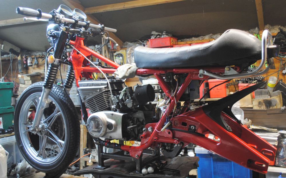

sorry no updates for a while, but really busy tbh. anyway, this is how my monoshock reed valve ramair gt250 sits as of today. several bits off for powdercoating and fuel tank/sidepanels getting ready for paint. if i get chance later i'll post some inbetween photo's of all the work i've done on her
cheers, dd.

thanks alan, one tries one's best you really don't want to know what garry double r has just offered me for a project, you really don't. anyway, here's a few more piccies of the reed valve build
cheers, dd.

Did you make the grab rail - looks good . and what about the swinging arm - where's it from??
I've no doubt missed earlier postings..
- Posts: 630
- Joined: Fri Aug 11, 2017 7:09 am
- Country: england
- Suzuki 2-Strokes: several gt250 ramairs
Re: gt250 reed valve engine
hi dax, sorry for the late reply, but i keep forgetting about this post grabrail is off either a 750 or 550 gt, suitably bent, rebent, rerebent and modified to fit the 250, couple of extra brackets welded on and powdercoated chrome the same as the wheels. looks far better out in the sun. the shade in the shed makes the colour look like silver. rear light now gone and a proper gt dogbone rear lamp fitted. swingarm is off a yzfr-125 yam, as is the rear wheel, hugger and shock. front end is gt250 - mostly - with suzuki gs450 wheel. front mudguard was just bought as a bare 'blade', so i added some gt stays and brackets to it, drilled all the holes in the right place and fitted. best of it is it's stainless. just needs the hole for the speedo cable guide drilling and it's done. very enjoyable build, just wish i could stop changing things
cheers, dd.
