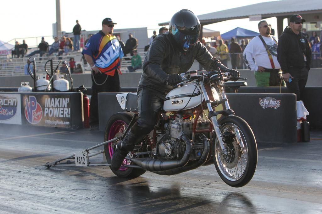

Re: GT750 Drag Bike
Great picture of the launch Kevin.
For next year what's the plan, lower and lighter and sidewinder pipes and even more power? Lectrons perhaps? Even higher compression? Nitrous? Turbo? Clutch upgrade? Reeds with extra transfer ports perhaps? Hollow titanium axles? Ti and Aluminum bolts and nuts? There are so many ways to spend money chasing those thousandths of a second.

You know me better than that Richard... Ebay parts and Flannery Performance....

Re: GT750 Drag Bike
Post by D&D CHASSIS »
Definitely lower and lighter.........
New hard tail back half
Raked
Backbone fuel cell
Aluminum triple trees
Lightened forks?
aluminum front axle
Aluminum wheelie bars
Aluminum tail section
aluminum side covers
Narrowed fiberglass tank shell
fiberglass front fender and headlight
"Downsized" brakes
Outboard sprocket bearing support
the only other thing I would do to the motor would be eliminate what's left of the water pump. .......
Get the bike down to about 280-285lbs.......put Brian Pretzel on it and go 8.80's
Re: GT750 Drag Bike
Dave,
while we are busy spending Kevin's hard earned cash, we should add a
Billet bottom triple clamp with aluminum stem and top nuts
Lighter front caliper
Lighter floating front disk with aluminum center
Billet top triple clamp
520 chain conversion with lightened front sprocket
Aluminum or TI ignition mounting bolts
Mill some of the surplus metal off the cylinder block. There's a lot of solid thick aluminum that can be shaved off.
Don't know how much that rear wheel weighs, but worth considering an FZR400 rear wheel and lightened disk with tiny Brembo caliper.
Use a stock water pump shell and make a press in plug to replace either the bearing or seal to block off the water - or make a plug that replaces the water pump. And replace those heavy steel front water drain plugs with aluminum or weld them shut.
And then add straight cut primaries and Nova transmission and slider or lock up clutch.
I do not want to add up that Santa list, but I know it would be just a touch outside my budget :roll: :?
