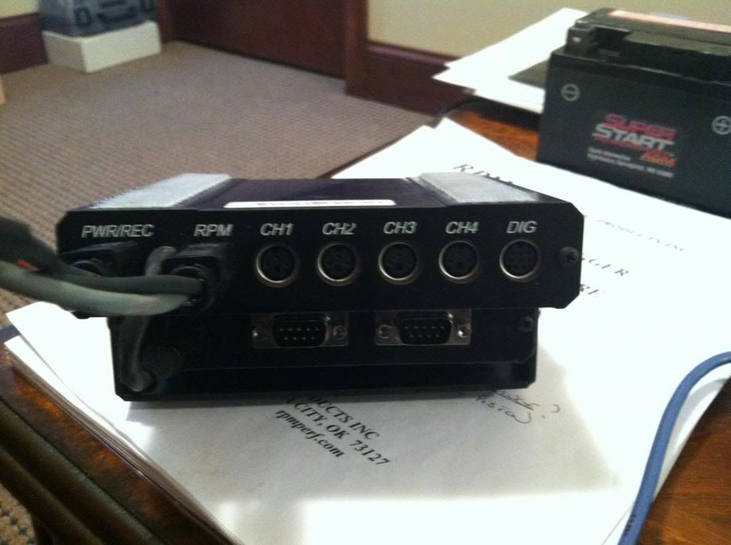

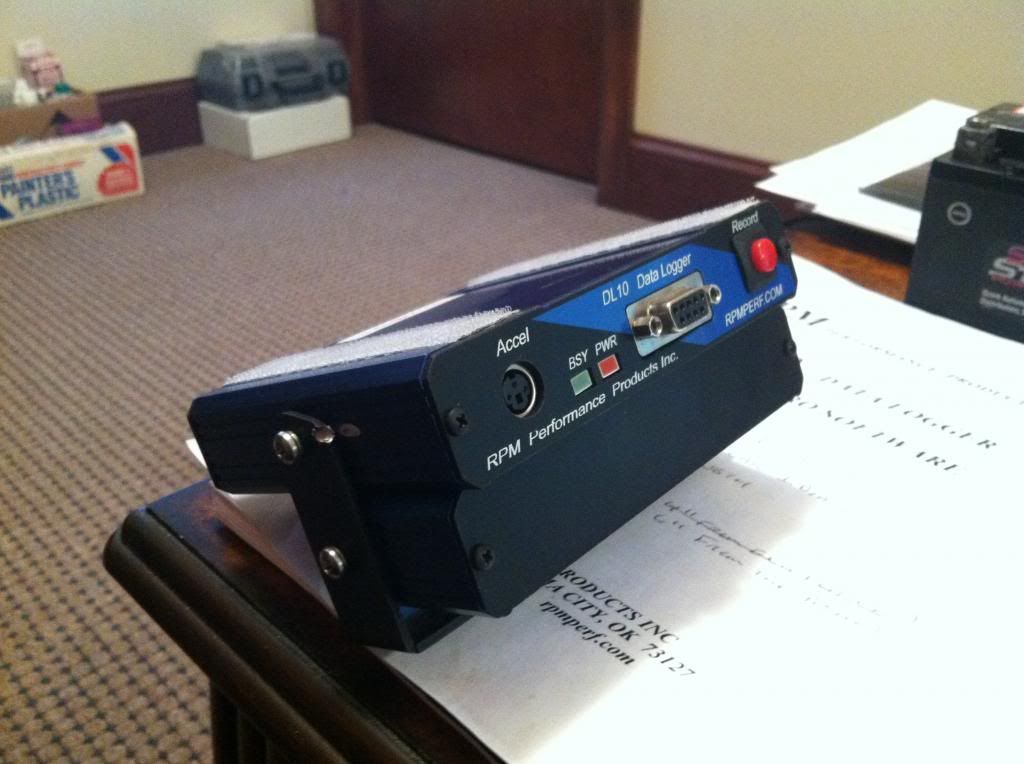

Working down my list of mods to get ready for Spring. Some are for show and some for GO....!
Rear Sprocket change
Install Data Logger EGT, RPM etc.

Add Remote Record for Logger

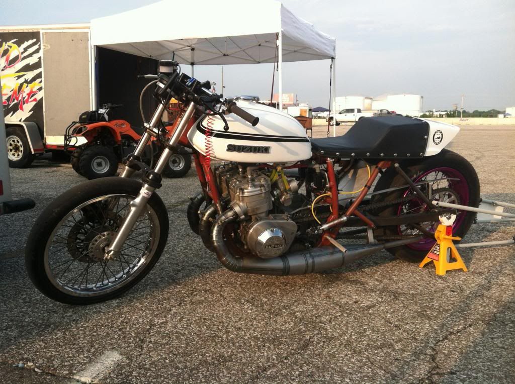

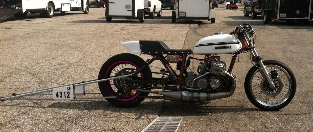

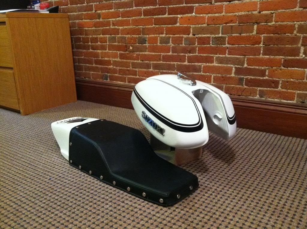

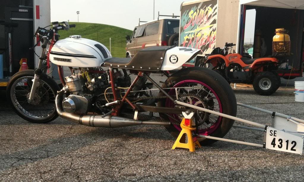

It bothered me that I had a 76 tank on a 74 bike. For a long time, I wanted to straighten that out. So I got a decent 74 tank on ebay and started the process of cleaning it up. I bought the POR-15 kit to restore the inside of the tank. I've tried the KREEM kits but I liked POR-15 better. I think it was $35 and comes with everything you need (except patience) to completely restore the inside of the tank. This particular tank was pretty rough on the inside. http://compare.ebay.com/like/1209375918 ... s&var=sbar" onclick="window.open(this.href);return false;" onclick="window.open(this.href);return false;" onclick="window.open(this.href);return false;" onclick="window.open(this.href);return false;" onclick="window.open(this.href);return false;" onclick="window.open(this.href);return false;
Then, I bought Valspar Primer and Paint, and Dupont Clear Coat. Since I am not a painter and have no equipment, I also found a Paint Spray applicator from PREVAL. I thought it was much better than rattle cans and only cost $6. So I bought a couple of them.
Primed, Painted, Decals applied and then 4 coats of clear. New gas cap and secured the SUZUKI tank emblems with 3M Plastic Emblem Adhesive.
I dont think I should give up my day job....but for my first real attempt at painting, I think its ok for what it is. Last year, one of the racers decided to sell some of their equipment. I was very interested in the Data Logger and even wrote about it a few pages back. Anyway, we struck a deal. I had an old PC in my closet. I dusted it off and figured out how to get it working properly again. Then, loaded the RPM Performance Software, ran a bench test and found a spot on the bike where it would fit. Unfortunately, the coils were there and will have to move under the tank. The logger is small and very lightweight. It has 3 EGT probes, wires directly into the MSD ignition for crank rpms, has a "C" ring for clutch rpms and has an accelerometer to measure the launch. The logger will record about 30 second per event and will initiate off a signal once the engine rpms rise above 5000. should be able to fine-tune shift points and compare engine rpms to clutch rpms to see how much the clutch is slipping and when.
The frame will go off to welding and sandblast next week and then painting will start. The wheelie bars will get done at the same time and finally match. The wheelie bar supports were moved to add stiffness and the rear sprocket went from 50T to 52T.
I added some new switches to the handle bars...one for the ignition ON/OFF and one for the remote RECORD for the logger. All in all, I hope these changes will be enough for some additional improvement and also make the bike look a little more professional. Its time.
