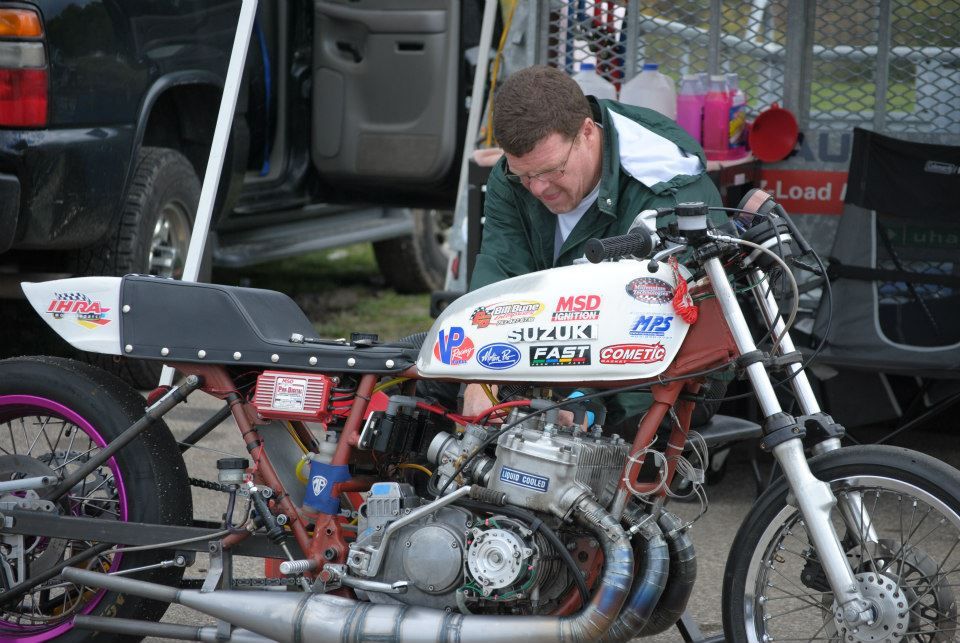

Regular plugs tend to melt before Iridium tips because they hold more heat. What heat range were the plugs. I figure a 9 on the street is OK for a hard ridden motor and 10 on the track but I don't think that Iridium gores to a 10. What did the other plug tips look like and are they showing any sign of overheating?

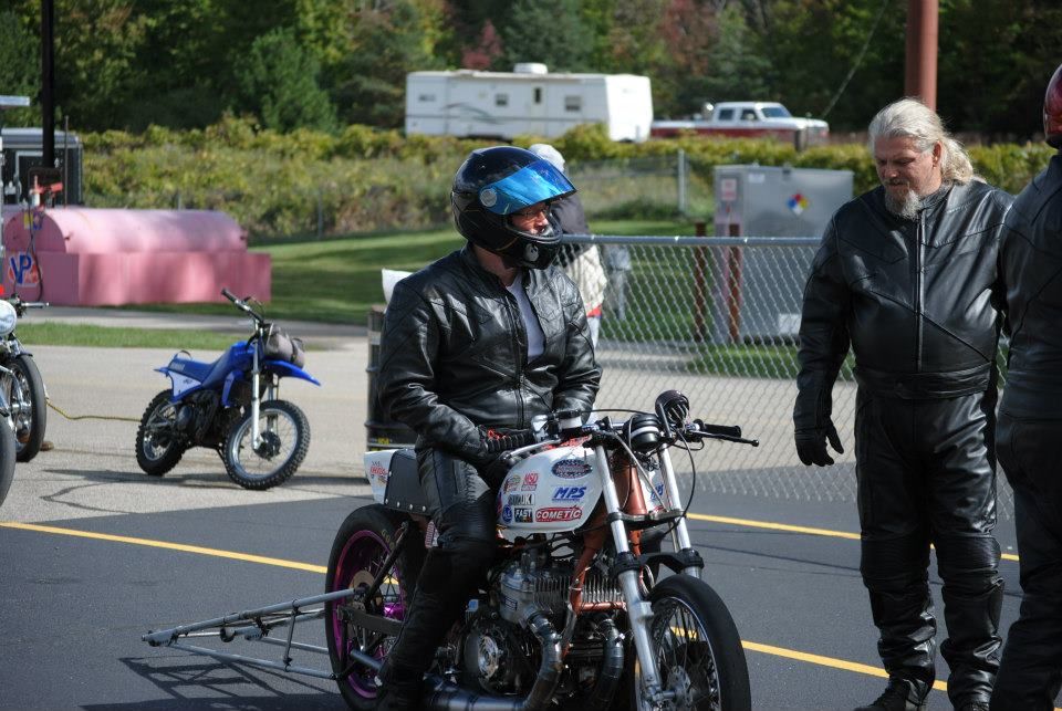

Turnout was great. We had 22 bikes compete this weekend. There are several riders working on bikes this winter to join our group next Spring. It would be great to approach a 30 bike field by next Fall.
I went out in the first round against Gary Seeley. I figured I needed a perfect light and perfect pass to beat him, none of which happened. When youre running against Gary, any tiny mistake will cost you the race. A bad reaction and some tire spin off the line was more than enough to put me on the trailer. Gary went on to win in the Finals against Gary Connors. Connors won the Indy race back in June. These guys are tough...no doubt about it.
Although none of us ever want to loose, I am happy with the bike and current performance. Im sure I'll catch a few weekends with Smokin Joe up at Thompson's Dragway in Ohio and resolve the traction issue. When that happens, a 9.99 wont be far behind.
R, Im running NGK BR8-EIX. Only had an issue on the center cylinder wire. Left and Right looked about right. The heat range seems to be right too...just a little lean at the track. Doug had me take out a couple degrees of timing.

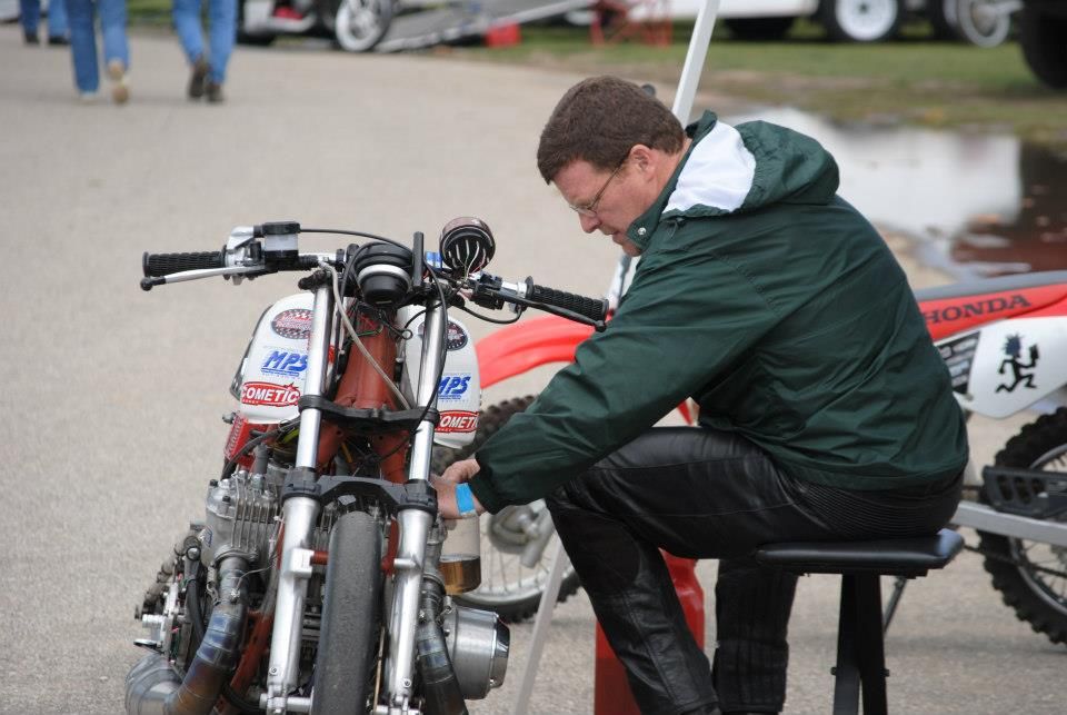

Looking real mean there Kevin .. i see you put the EGT assembly back on , are you getting a proper reading with the probes pointed to the back of the pipe ? Is your temp around 1200 deg on the top end ?

Dave, I wasnt getting all 3 to read right. The probes are perpendicular to the flow and initially I had them adjusted so the tip was in the middle of the pipe. Later, I moved the tips back to about 1/4" and have to confess, I didnt check them on that last pass. I did checked the wiring tonight and found one of the thermocouple wired backwards in the patch cable so I corrected that. Should read fine now but I'll test again at Thompsons. The middle cylinder did give a good reading of 1000-1100F during one of the dyno runs. Someone suggested i use one of those cameras and set it up to record the EGT adn RPMS during a pass. Sounds like a great idea.

A helmet mounted camera might be a very cool way to record both your pass and watch the readings , i do feel the egt probes do work best inserted thru the back of the bend like you had with the Jemco pipes as the hottest gas flow should flow along the outside of the bend .

Highest temps are in the center of the pipe and on a bend that moves out a little but skin temps are lower than the gas in the center of the flow.
This is where a datalogger would pay for itself really fast in setting things up. 1100 is quite low in conventional thinking but that depends to an extend upon the pipe design where peak temps are. A few inches either way can make a huge difference to temps. What's important is that if the dyno temp was say 1100, then at teh track you want to see that same number or close to it.
Dave's right about the bike and rider looking more serious and focused each time we see a picture.
