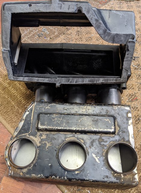

back to the air box - collected this today - front is GT750, top is part of a T595 airbox..........
the metal box was only tacked together as it may not fit (because I measured it)..........
it fits :up:
I was 1cm out - the 3 metal trumpets require shortening by that amount to allow the fuel tank to sit flush.
