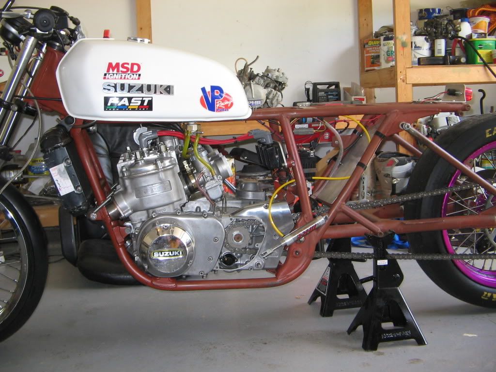

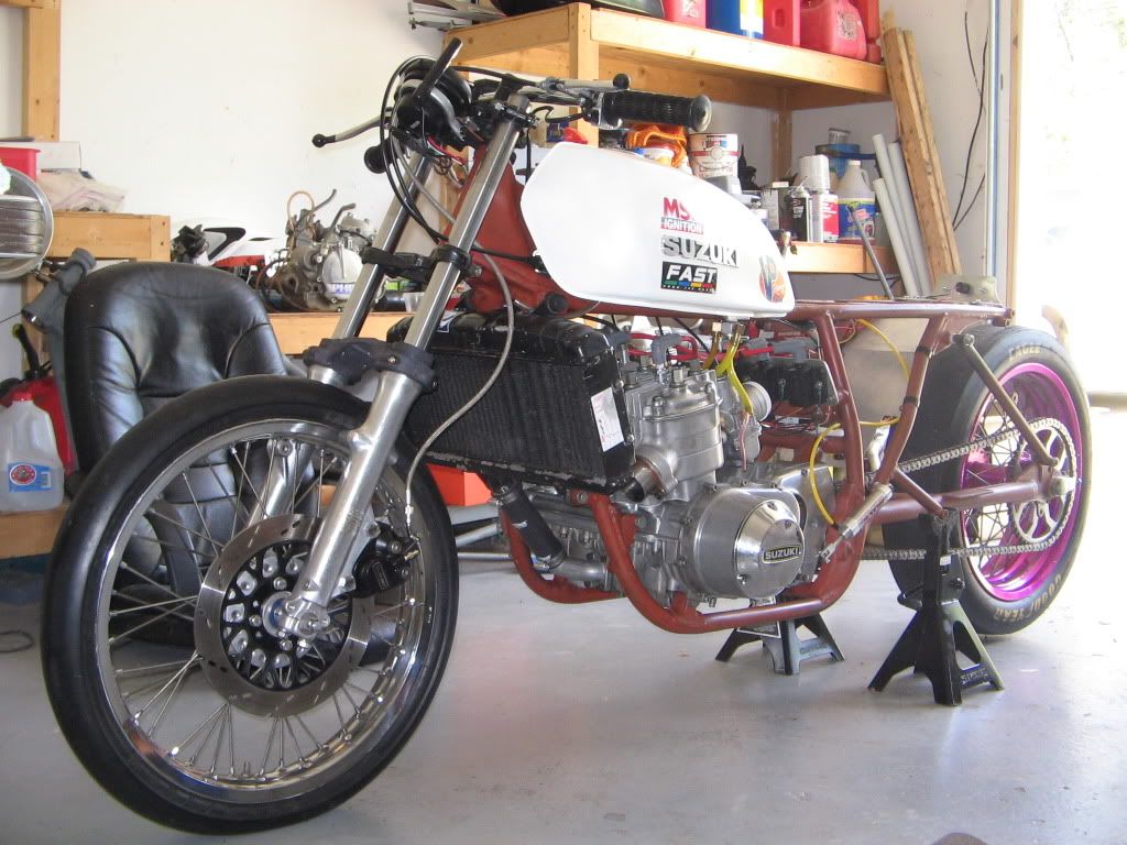

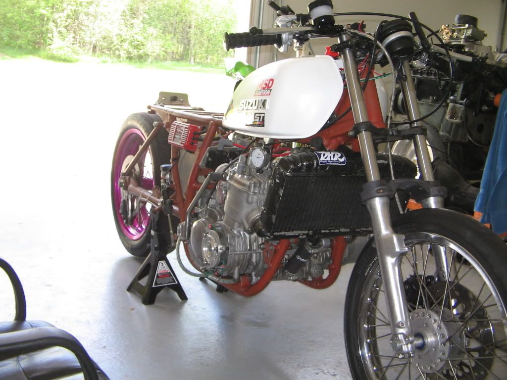

water cooled wrote:New and improved for 2010...nearly complete. Steve Hamilton...I want to say thanks for putting up with me. I will do my best to bring back some fast ET's.

Hi Dave D,
I was getting anxious to hear it run too...I finally got it going yesterday morning and it sounded great in the crisp 7am air. My wife came flying out of the house in her robe asking if I was crazy...I thought I showed great restraint waiting until 7...
A noticeable difference in the way it sounds compared to last year. I'll start packing up tomorrow, get the trailer loaded Thursday and leave early Friday getting there around 9:30a. Looking forward to seeing you and Matt there. Hopefully Doug will be there too and Im sure he will want to check it out. :D 8) 8) 8)
Thats fantastic news Kevin that she fired up nice and hoping all is water tight now ? The squish head didnt give you any problems ?
water cooled
Posts: 704
Location: Medina OH
Post by water cooled »
Hi Dave
Only a tiny drip on the RH side outer edge. I didnt get as much copper spray out there as I should have and Im at the limit of the 8mm bolts. I used 2 oz of Bars Leak and it seems to have done the trick.
I finished off the air-shifter lines this morning and the system is holding 100 psi for over 1 hour.
No issues with the inserts but I made sure they were perfectly concentric to the bore. I assembled the head, copper gasket and block together (upside down) so I could see everything. Then, installed the block assy onto the motor. I wanted to have the head aligned and pinned to the block but we ran out of time.
I have no idea what kind of power the setup will produce yet. The only thing to watch for is that the RH spark plug interferes slightly with the stock coolant line. I think you have a different radiator setup so it shouldnt be a problem for you. After the Martin MI race, I plan to install the RM65 radiator which will give me the clearance I need.
