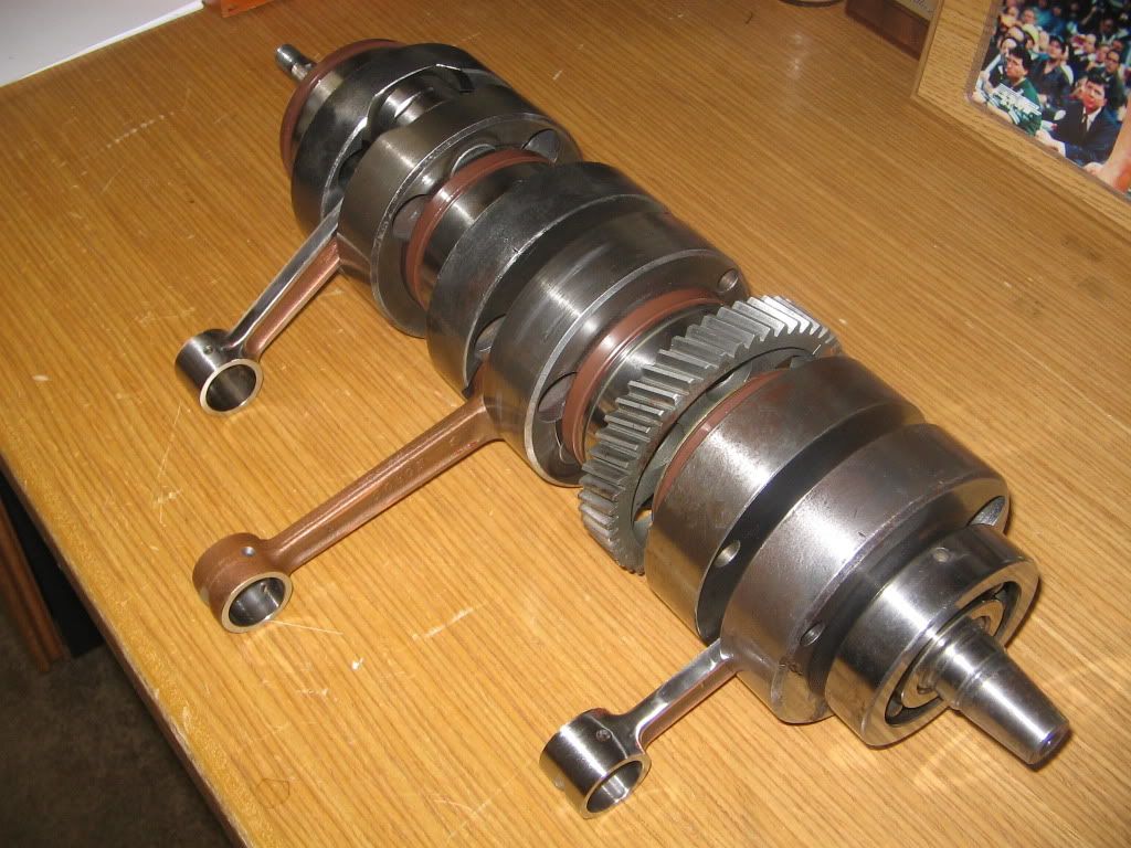

Rebuilt Crankshaft
Post by water cooled »
Here is the freshly rebuilt crankshaft from Bill Bune. New seals, modified oil slingers for premix, matched rods...Old seals showed evidence of damage on the ID lip of one of the center seals. Also found an indentation on the lower case that may have allowed a very small amount of transmission oil to get drawn into the center cylinder crank area on the up stroke. Pins were still tight so welding the crankshaft was not done.
Now that is really a thing of beauty !! :D

Good for a zillion horsepower!

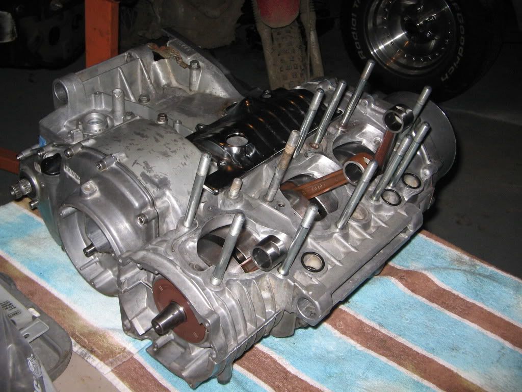

Improved GT motor going back together...

Still waiting for the block and heads/ I have gone about as far as I could. I knew I could make progress if I got the upper case so I asked for that back first. I need an 18mm freeze plug for the tach hole and will convert the carbs over to power jets on the advice of a great racer in the UK that knows this GT750 very well.
I used the light weight rotor you gave me last year. Turned it down to 10" and installed on the 18" alloy wheel. Im trying hard to keep the GT look and feel where possible but saving weight becomes far more important.

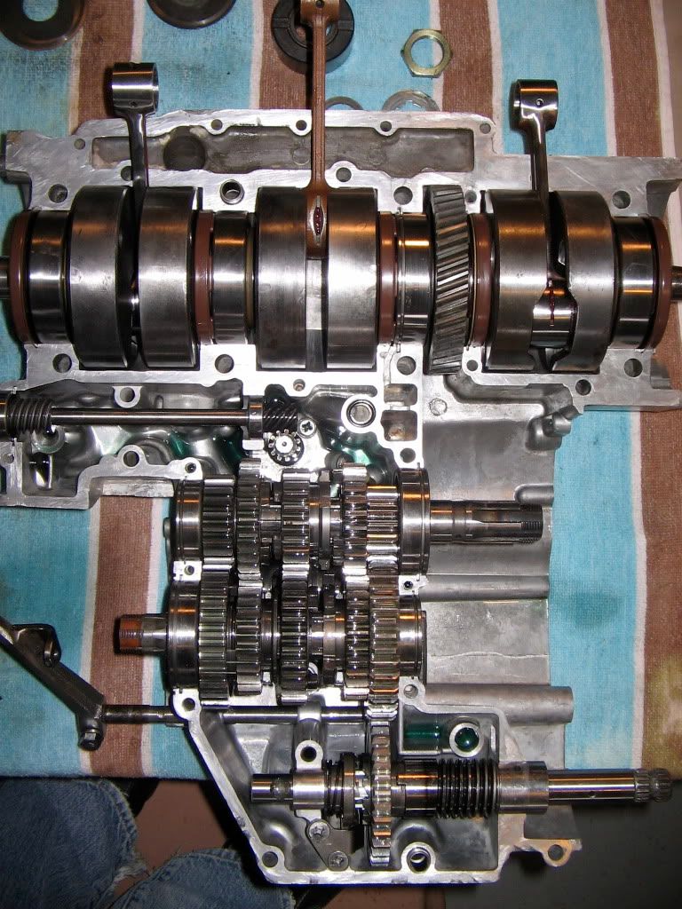

Assembly is looking good Kevin , they really had to remove some metal off the end rods to get them all to match up didnt they ?
Bune said that two of the rods were not like the other...they came from a different time and place so they put the light one in the middle and matched the outer two. They were pretty far out from each other.
