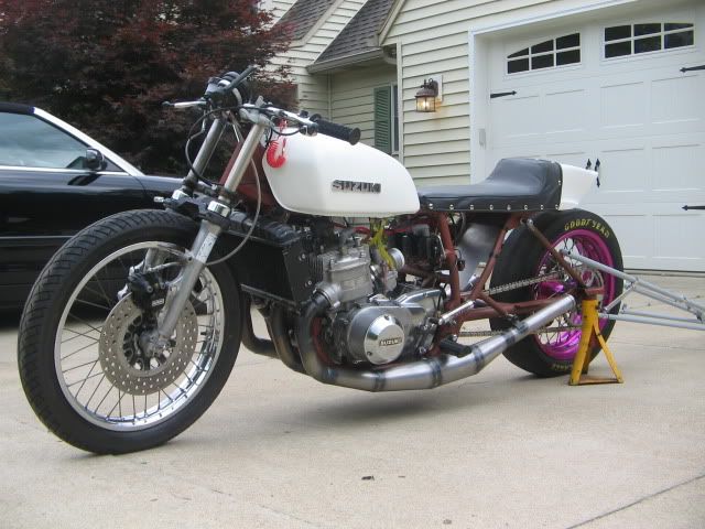

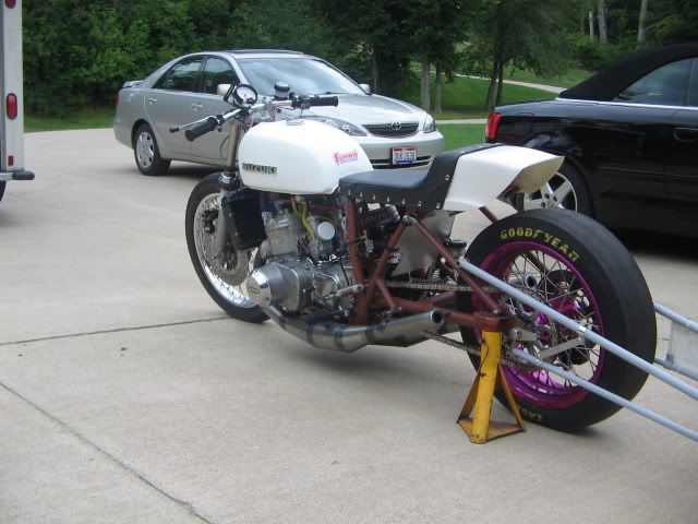

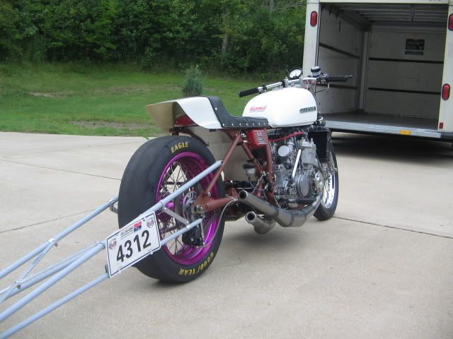

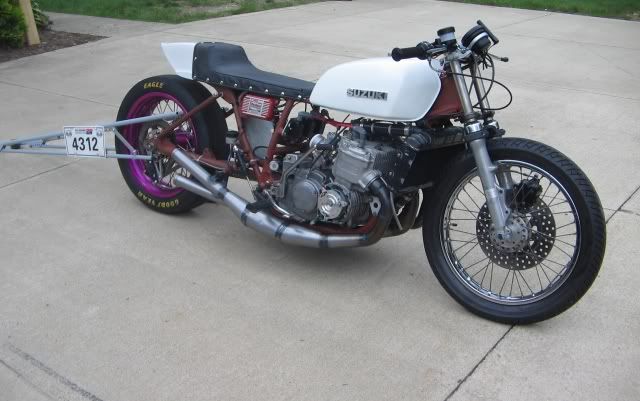

Here are a few pictures from today just before I load up the bike to head to Indy.
