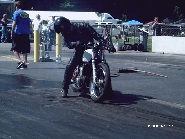

Here is a pic during the first round of eliminations. Before I staged, I checked the carb to see if they were still on the bike...when I hit throttle...the carb manifold let go and that was it. Further insult to injury, I red-lighted with negative .0492 but a 60 foot ET of 1.9032. During Qualifying on Saturday, I had one run with a Reaction Time of .0603 and 60 foot of 1.969 which is much better for me than Norwalk.
