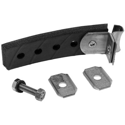

Chambers should be rubber mounted at the pegs on a T500. You can use a cheap fabric reinforced auto muffler hanger for the rear mounts as well. Desmocat showed me this one although I can't find the exact part he uses. Basically you cut the metal bit off and use the rubber. If it conflicts with your rearset mounts, make a 1/4 in alloy adapter plate that has three holes in it - two for the rearsets and a third hole further back to bolt up the rubber muffler bracket.
http://www.autozone.com/emission-contro ... 7809_19329
Sounds like the local welder will be cheaper than shipping back to Higgspeed but not by much if it takes him a couple of hours. Plus if he's repairing a tear in the chamber - will he make sure there's no "slag" that blows into the pipe from the repair welds that could alter the chambers performance?
