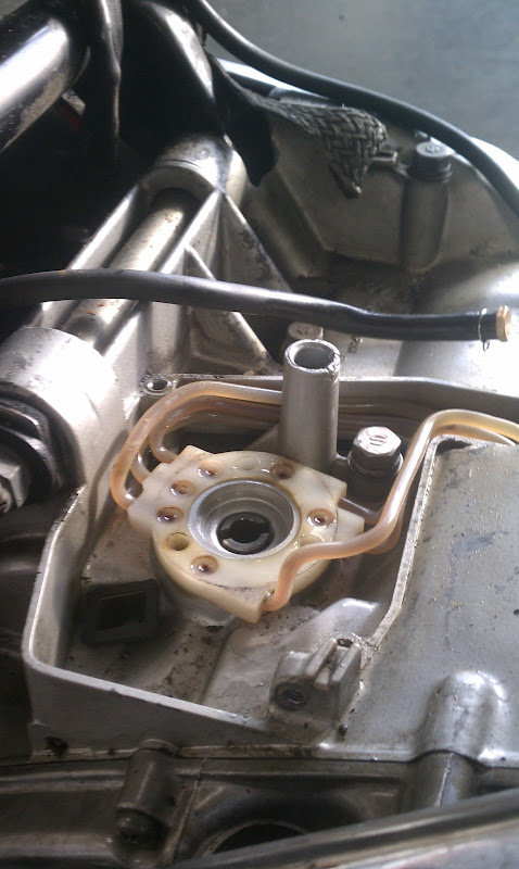

Was able to pull the pump and lines (octopus I'm told?) today following suggests from this forum. You guys are a great resource! :up:
Everything looked pretty good. I rotated the pump a few times with the supply line still connected and got oil out of all the outlet ports. The oil was a little reddish. Is this something that happens to 2-stroke oil when it sits for a while? The octopus also got cleaned and re-filled. I'm thinking I'll swap the old oil for some fresh stuff before I give it a run. I'm hoping the initial run happens in the next week or two!
ooh, one more question. Are the o-rings different sizes? I tried to match them back to the port they came off b/c they looked to be different. Not 100% sure if I got them back where they should be. :oops:

O rings are all the same. make sure they go in the oil port holes and not the mounting screw holes. And be sure that you don't drop the drive pin. Oil does oxidize given enough time, so if the oil is years old, I'd drain the tank and replace it with fresh oil - just to be 110% sure.

Where do you rotate the pump ? Do you turn the cylinder at the top, directly under the pump lid or where the cylinder attaches to the octopussy ? I read a couple articles about testing to see if the pistons are sticking. But, those articles I found to be a little vague. Can you use a nail set and try to gently push the pistons ? To verify that they are not sticking. Also, should the ends of the pistons be nearly sticking out of the holes at the bottom of the cylinder ?
Re: Restoring a '75 GT750!
I would point you to the Pinkpossum.com site, but the hosting company seems to have a problem (still).
The shaft sticking out of the bottom can be rotated by hand or by removing the drive pin and use a pin punch or long piece of stiff wire.
That shaft is part of the plunger assembly and the pistons are inside that plunger ass'y, inside the main casting. It's not possible to see them without stripping the pump. If oil discharges form all 6 outlets it's unlikely that one of the two pistons are stuck.

Thank you, for clearing that up. The writer mentioned resistance needing to be felt. Where should that resistance be ? Once you turn the shaft ? Sorry, for the thread jack.
As the plunger and shaft rotate, the top surface of that plunger is shaped like a face cam and it rubs on a pin in the top cover forcing teh plunger to rise and fall - hence pumping the oil. The more the lever is rotated, the further the plunger will reciprocate as it rotates. That's where the resistance comes from and it's why the lever will not always return . It's "sticky" nature is when the plunger is on the cam.
