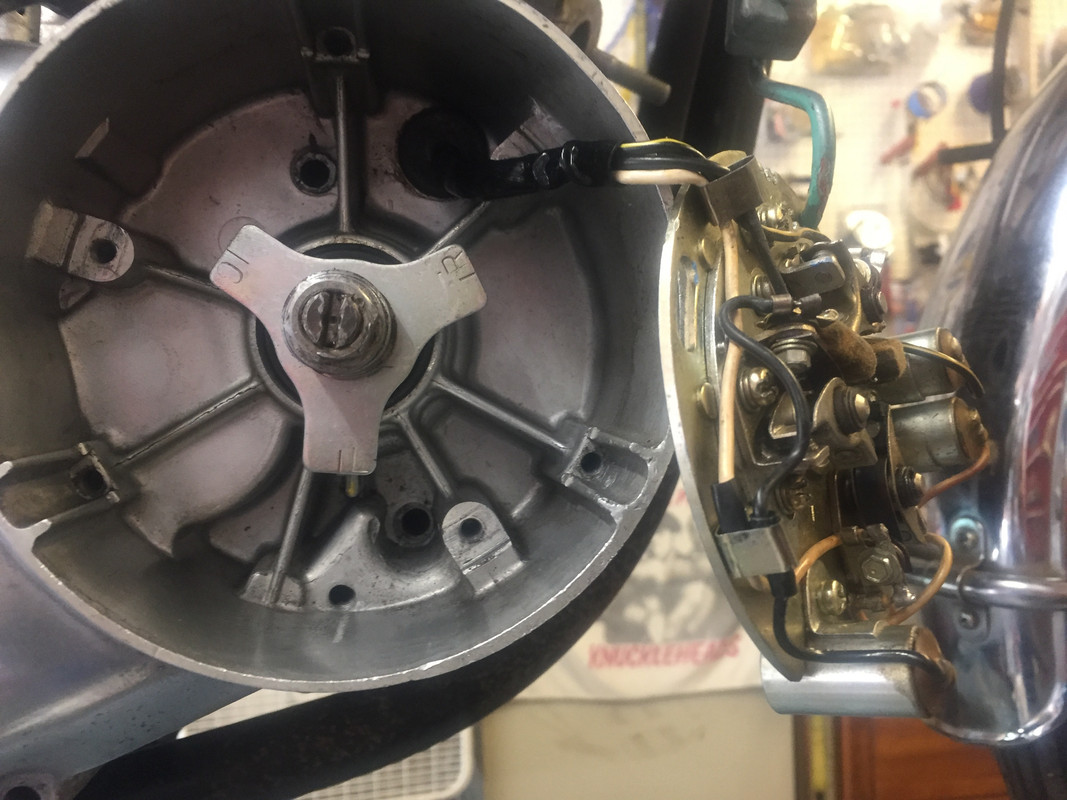

Here's what I attempted today:
1. Align timing mark on drive gear to arrow in side case.
2. Install case cover with red line (L mark on points cam) aligned with line (yellow painted) in the cover. Not happening. This results with 2 teeth
meeting head to head. I took a bunch of pics where the gears meshed. Close, but not perfect. I would either have to cheat the drive gear off its
mark, or settle for where the cam mark is landing.
This is where it lands.
Here are the other mesh points where the cover can be installed:

I don't understand why it has to be dead on, anyway. Isn't that why you rotate the points plate, to fine tune where the spark happens?
The gears are meshing "in the ballpark". When you use the dial gauge to set TDC vs spark via rotation position of the points plate, that is where
the timing precision comes from, right? Maybe I'm in over my head. Luckily, I have a couple friends that can come over and help me on this.

Yep that's what I advised about.
Yes you rotate the points plate, but if it is like mine, you will find the screws in the plate slots will be all the way to the end of the slots.
On mine, I went on the retard side of the cam tooth, I got proper timing but have very little adjustment in the points plate slot.

Today, I rotated the cam drive gear clockwise so that the pointer was aligned with the first space counterclockwise from the punch mark. They should
not be telling you to align with the punch mark, since you will just end up trying to mate a tooth and a tooth.
The case then went on in a few seconds, and the mark is now almost perfect.
Anyone know which way the cam drive gear rotates when running?
Guess I can tighten the side case on now. Hope it doesn't leak! Time will tell..

Points cam shaft turns counter clockwise, opposite to crankshaft.
