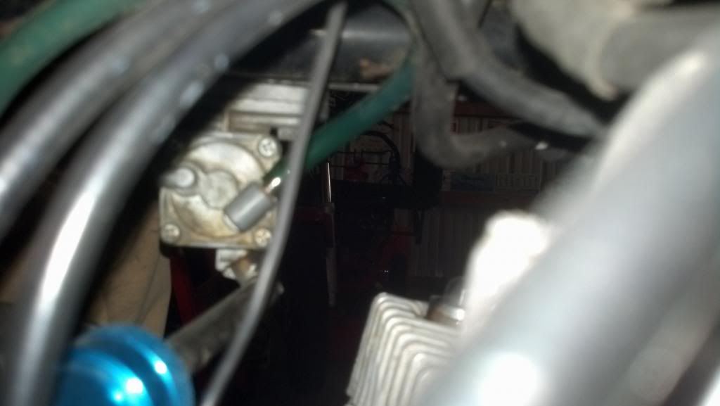

This particular petcock was fitted as standard on a one owner 75 Buffalo from new. It appears to have no filter screen and no catchment bowl on the lower portion. Has anyone seen a design like this before???

it appears to be a GS550 petcock. probably fitted by a dealer/mechanic to replace the original.

A quick explanation in case anyone else wants to try their own search for parts.
I looked at the photo and could see "470" and that's usually the model code. On a GT750 that would be 210 or 312 typically. No guarantee but a good place to start looking.
Then I looked up the GT750 fuel tap and it came back with 44300-31051. 44300-33151, and 44300-33152, So I tried 44300-47051 and google turned up several references all as a superceded part fitted to a 77/78 GS550E.
That doesn't mean my deduction was correct, so I google images of a GS550 fuel tap and some of those images looked just like this one. Close enough for me.

Only one problem with that deduction Richard is that a GS550 didn't exist in 1975 when the bike was bought new by the one and present owner. According to what I'm told by the owner it was bought this way and thats the tap it had on, so what other bike could it have come from back in 1975???

Could it maybe be a RE5 petcock ?

That looks similar to the one on my 78 GS1000. It's square like that one with no bowls or screens The big difference is the outlet on mine is horizontal on the right side when viewed from the lever side. Can't say I've ever seen one with the outlet on the bottom like that.

Got to believe that it was fitted by a dealer when there was a problem with the original, after the year of original manufacture.
